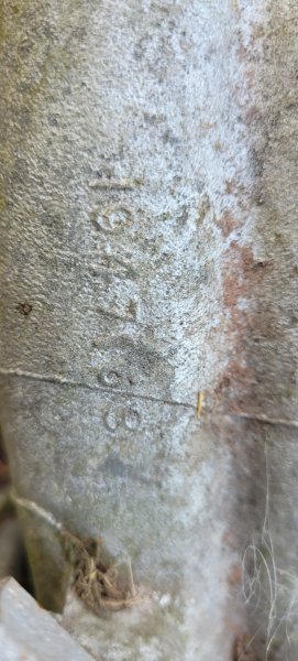

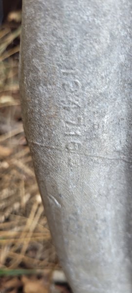

I have a long tube cross ram I wondered if anyone could help me out with the year and application it was for? Thanks
They were used from 1959-64 on the 383, 413, engines in the Dodge, Chrysler, Plymouth, line of cars.
Pretty common back in the day, but not any more, in this day and age.
So just take your pick, on year application.
The number you have was used on 1960 and 1961 only.
All 413 Chrysler 300's and then optional on Dodge and Plymouth 361 and 383's.
They were never used on a 1959
1963-1964 used "short rams" the divider was short and a different casting number.
They were used on all 1963 Chrysler 300J, and optional on 1964 300K
Short rams were optional on 1960, 1961, 1962 high horsepower optional engines.
