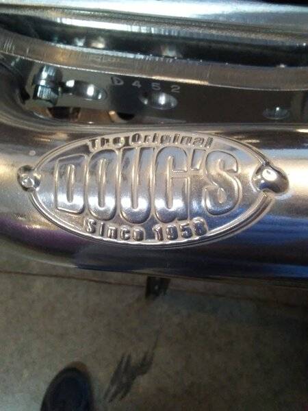

Currently installing Doug’s on my 67 coronet w/440, what a PITA. Had to pull the sterling column and go in thru the bottom all while trying to install a mini starter at the same time. I’ll report back with any fitment issues.

I decided to spend the extra $$$ on Doug’s so hopefully I won’t have any figment issues. Paid $775 from summit using a discount code from jegs. You can get them from Doug’s website and save 10% by signing up for their email marketing, which is a good deal.

I put Doug's 2" on my B body 440 motor. Best fitting headers I've ever installed. No dents or dings required, 800 bucks was well worth it!! Plus they are beautiful.
