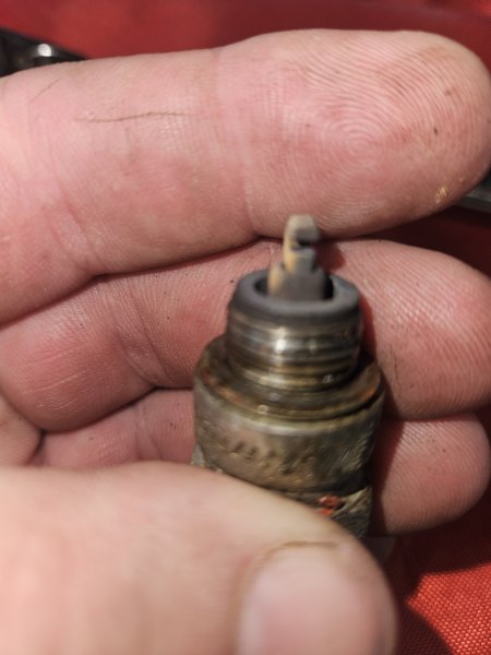

One side of the plug looks pretty decent... Other side looks rich. Any ideas on how this happens/what causes it?
The centre electrode is getting fuel wash on the grd strap side.
Using Iridium plugs will render indexing useless and a waste of time. :)
I use a sharpie to mark a line along the plug body to indicate the "open" side of the electrode, then install plug with open side facing up into the combustion chamber. Sometimes have to go through 2 or 3 sets of plugs to index them all.
What Bird 426 said below.....
Summit sells thin washers for spark plug indexing.
Likely the result of charge cooling.. nothing to be concerned about......incoming mixture tends to cool electrode that faces the intake valve. A bore scope could visualize the other plugs/valves. Interchange plugs side to side as suggested seems stupid.......how about just replace the engine......plus the usual bad grounds, loose/corroded bulkhead connections, vacuum leaks, loose carb hold down bolts, bad gas, etc......
