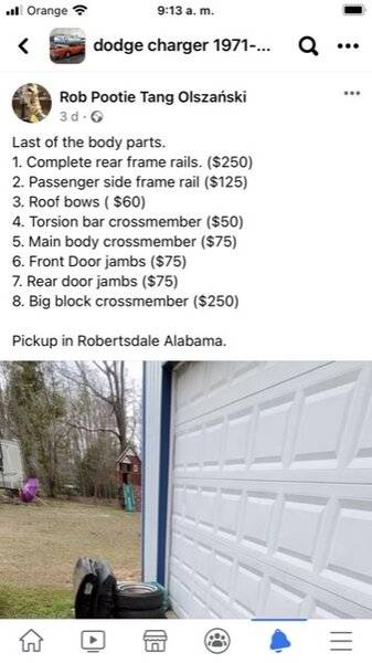

a member of this board got 74 rear frame rails for sale. The only diff I'm aware off with 71s it could be the bumper guard attaching provisions. He is selling on facebook. Rob Olszanski. I can't recall his nickname here...

He has been parting out A 74SE drilling out by the welding spots the entire car since mid year last year. That advertising on the facebook group is maybe 3 weeks old.
I think his nickname here is weaz..... something ( some numbers )

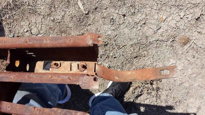

I know the reinforcements you meant BUT 74s are different and got bumper guards bracket provisions. The bumper bottom brace on 74 guards attach straight to the frame rail. Square holes to fit U nuts for the braces bolts. Dunno on laters

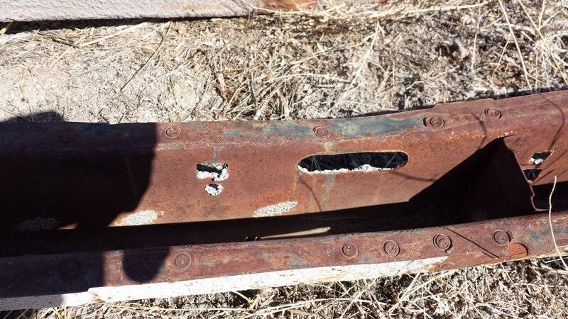

One difference is the driver frame has an oval hole for the 4 fuel vapor lines that is on 71 and 72 to May built cars. I've seen the hole in 73 frames but not in 74 frames.
Yes, some detail changes along the years.

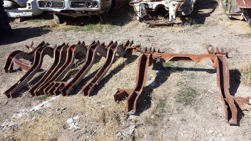

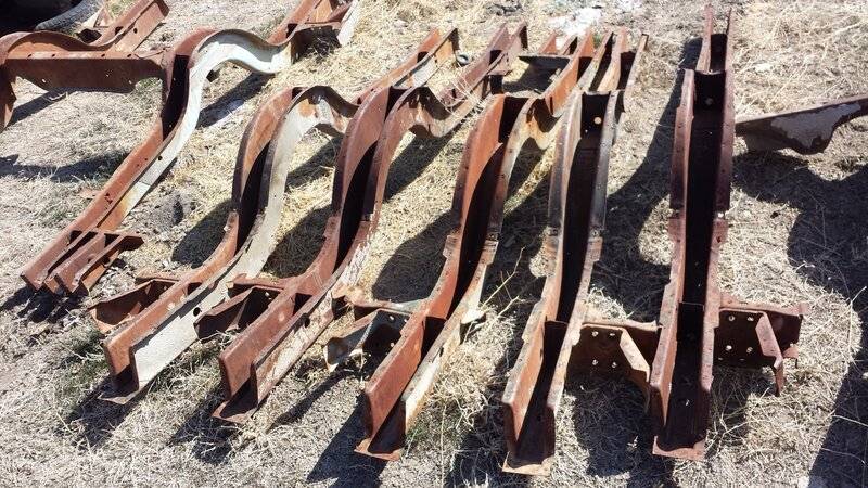

Here is what I have for 71-4 rails. All from desert cars but have been still out here in the desert. Mild surface rust. I can ship these truck freight but will probably be around 150.00. Shoot me a PM if your interested.
Here is the 71-5/72 oval hole.
Also the 74 Charger bumper guards braces that Nacho talked about.
