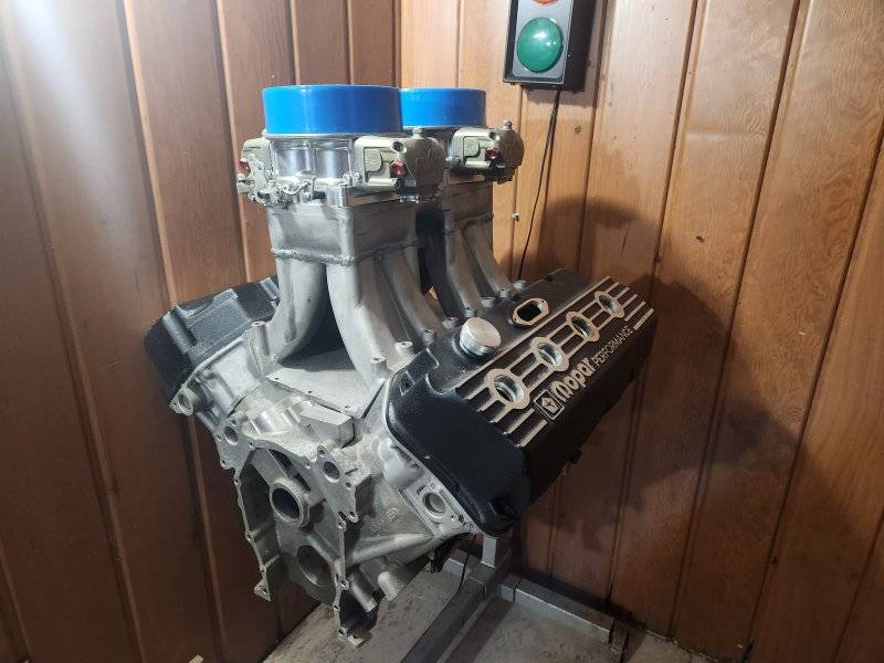

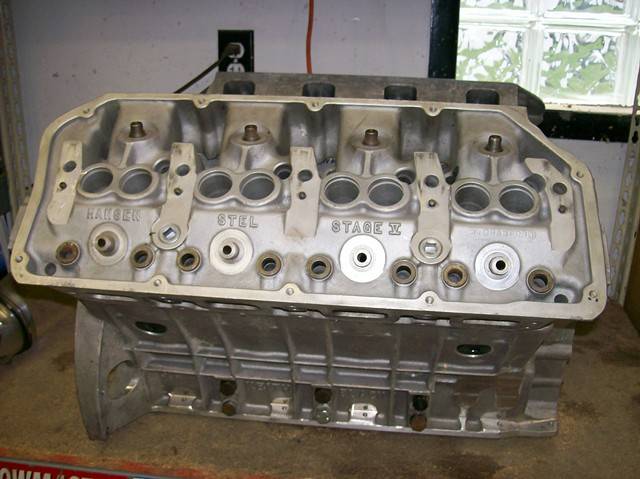

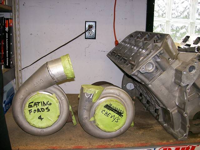

I have 3 KB aluminum Hemi (not Wedge) blocks. They are very nice pieces for sure.
Callies and Bill Mitchell iron blocks $5900. Indy aluminum block $7300. Kieth Black aluminum $8000. Then add to that to how much machine work is needed?
Doug
jealous !!-me
Using one for now as a mock up/display piece in my Racement (racing themed basement). Another one out on the shelves in the garage. The third is buried behind some other blocks out in the garage as well.
