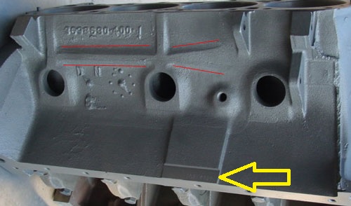

I'm not sure on the trans, but it can be done. I checked the one in my 69 rr and it was original. Vin stamped above the pan rail?
The engine is easy. There is a pad just above the oilpan rail (don't remember which side right now, check both) with a partial Vin,(last eight of thirteen) or maybe the full Vin on an early 69 build. Last six digits match the vin, original. They don't? It isn't.
Both on passenger's side.

The pad at the base of the distributor/ head area is what you should start with. If you want to know what you have there.

That is the casting part number of the block. There should also be another casting number set on the opposite side of the block from those, it will be the casting date. Then, as mentioned above, there is a pad underneath the distributor hole with some stampings, for 1969 it will have an E as the year, and the displacement, so it would read E383. There will also be the assembly month and day stamped there, something like 11 22 or such the like. There may also be some symbols stamped there, which mean various things like undersized bearings or bores, and HP for the high performance models or other such markings. Then as mentioned, the lower pan rail pad should have the year, plant, and sequential build number.
Did you find the pad on the block that Mark Levi pointed out? If its blank, it's likely a replacement block.

...if the pad that mark Levi pointed out isn't even there.... as Ramcharger said, it's an earlier block (68 or older didn't have that pad), and therefore NOT a numbers matching engine.

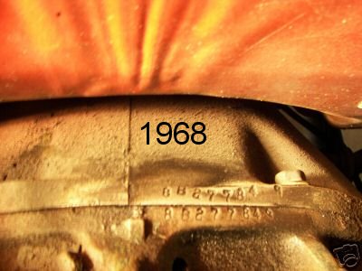

If it is a 68 block then where would the Vin number be located ? Or, didn't they put the numbers on until 1969 at the earliest ?

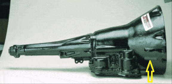

Vins started appearing some time in 68. They would be found on the back of the block,, at the trans mounting face, behind the driver's side cylinder head (if memory serves). The trans (if auto) would be stamped the same place.

I was going to say if it was an early 69 model car but built in 68 try to look at the edge of the block at the top where the transmission bolts up to it I have seen the vin on the transmission and the block right across from each other in the same place This is very close to where the oil pressure sender mounts on the back edge of the engine is where to look
