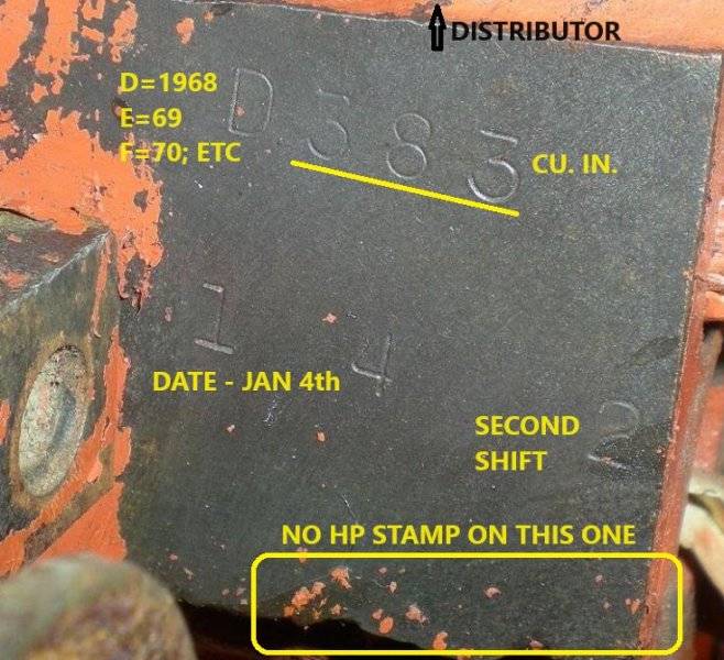

May as well check the pad under the distributor, and then we'll all know , what you have, and quite possibly if it's the original engine.
Do you have to remove the distributor to see this ? I checked for the clear area (pad?) on the motor just in front of where it goes into the motor but can
see no numbers/letters there, just the orange paint...unless the figures are "fine" and they are filled with paint? Do you have a picture of this by any chance ??
Tks,
Bob32268
Do you have to remove the distributor to see this ? POSSIBLY ...filled with paint? COULD BE picture of this by any chance ?? EXAMPLE
If there's nothing stamped on the pad, or maybe just a "WT" for 'water test', that adds to the likelihood it is a replacement engine block. You might need to scrape the paint.
I had to do some cleaning and paint removal to see the numbers on the pad:
D 383
3 6 2
rest of pad blank
So this would mean that motor was made March 6th on the second shift.... in 1968

I checked the distributor pad...it has the E 383, then the date and an "R" below the date...any idea what the "R" means ?
Tks,
Bob32268
...the "R" means ?
Correct on your engine.
On the other engine, "R" is for regular gas. Not a Superbee engine, which would be an "HP". VIN should be stamped on that being E/'69. That engine was most likely a two barrel as built. Some higher compression engines can have just a "P" - which indicates to use premium gas. With "HP", the premium gas is somewhat implied - usually ~10:1 CR. Other engines have a pad or location different from the 383 where you find these stampings.

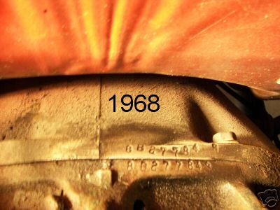

Good! Now, look for a VIN at the back of the block.

When each plant started started stamping it during the year seems to vary.
IF it is there, at the back of the block near the oil sending unit.
I crawled up into my engine compartment to look for the numbers as in the picture that you posted.... couldn't see any (unless they are light and filled in with paint).....is there
any other places where the vin would have been stamped on a 1968?
Thanks,
Bob32268
