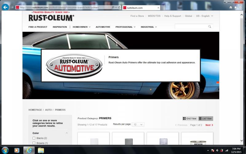

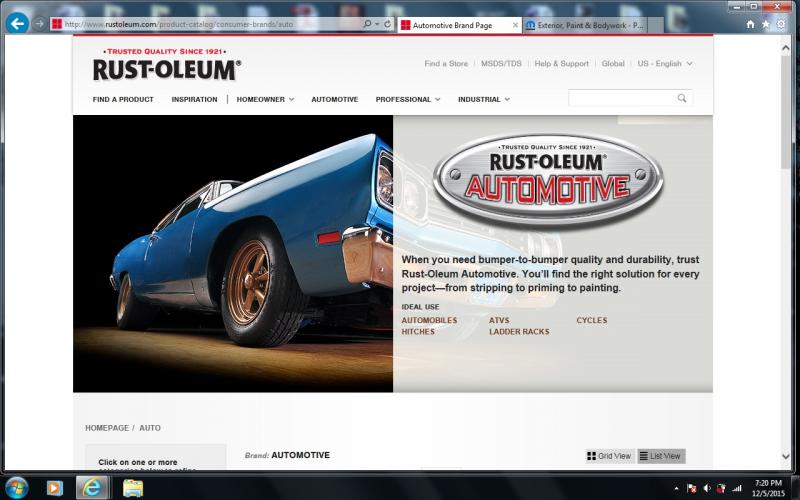

I was looking for a single stage sandable fill primer. (Not epoxy)
And I stumbled on these pictures. Nice to see it.
Found a single stage primer too. Not sure of the build
