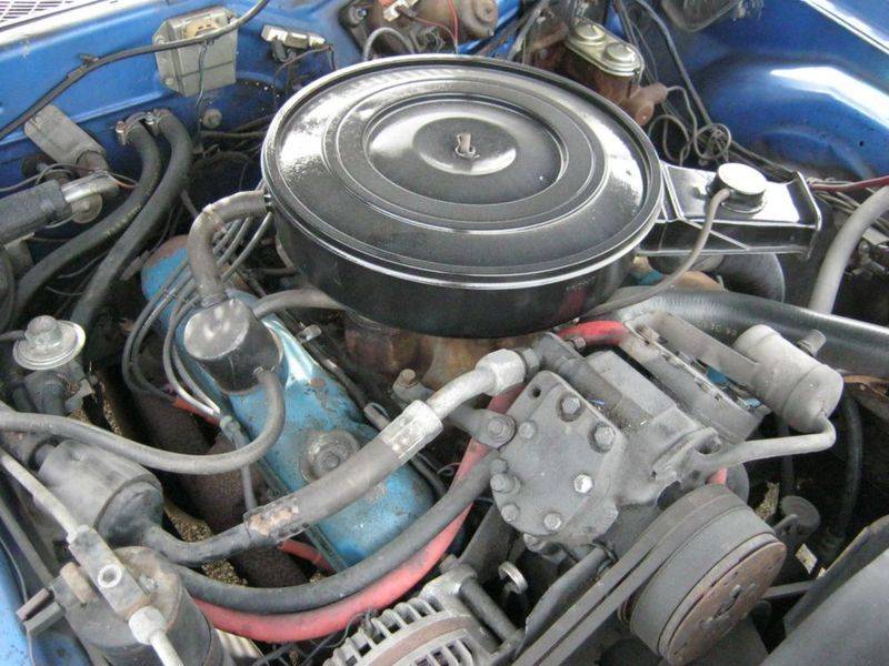

I just picked up my first B-Body and it has a 318 2bbl. I'm looking for simple bolt-ons. I need to keep it low cost to keep the boss happy. Any suggestions? What options do I have for Carburetors? I'm just looking for a bit more power and keep the relatively good fuel mileage if at all possible. What other things can you suggest? The car is a 1971 Satellite and the previous owner had begun cloning it into a Road Runner, but did not go past cosmetics.
