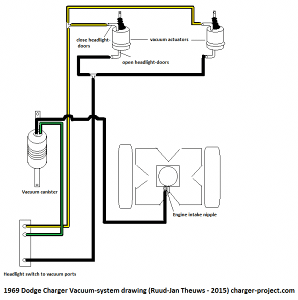

top one

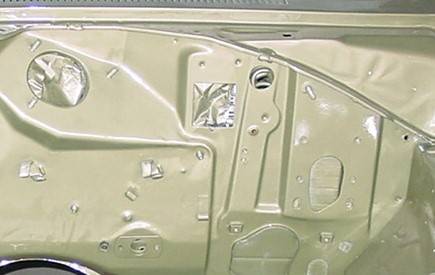

The correct grommet has 3 holes.
That hole is a lot bigger than 3/4". Maybe green440duster can measure it.
Original Mopar seems to be 2857950
Someone sealed up the hole before I got it and I now have to redrill it :( So I am not sure of exact dimensions.

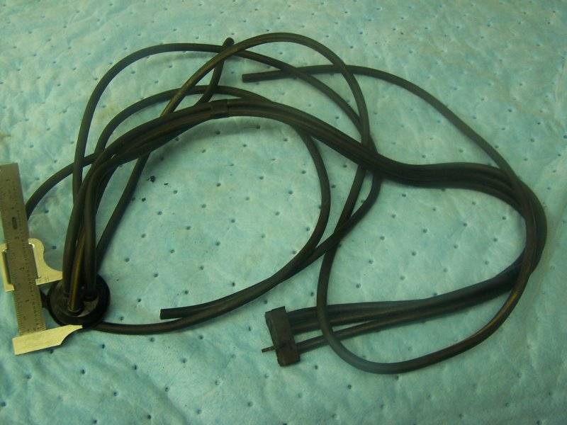

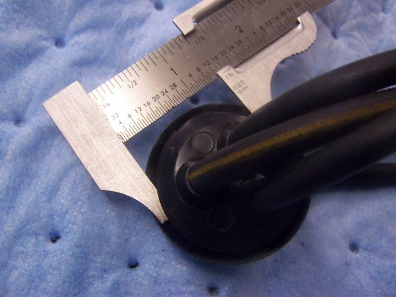

I will see if I can get you a measurement later today.

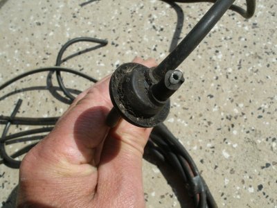

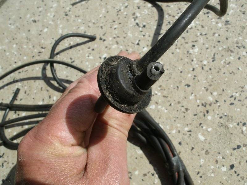

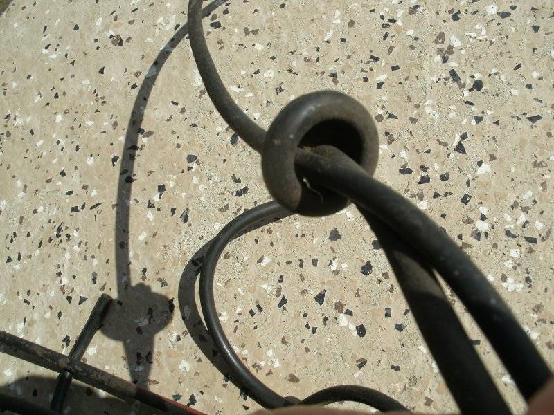

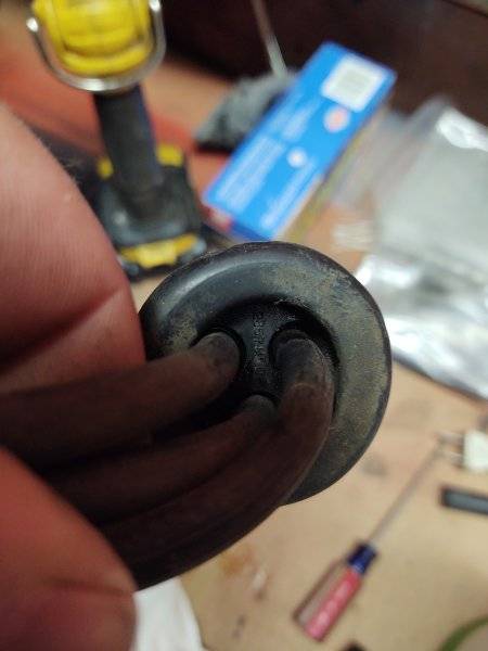

Here are a couple pics of one I have. Looks like the hole should be 1 3/8". Mega parts has the complete hose kit for $195.00. Includes the hoses between the vacuum pods. It has the firewall grommet so someone must make them.
