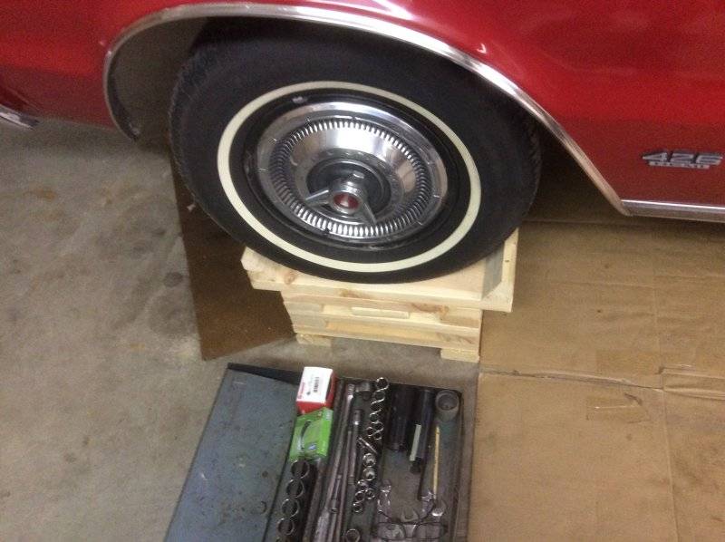

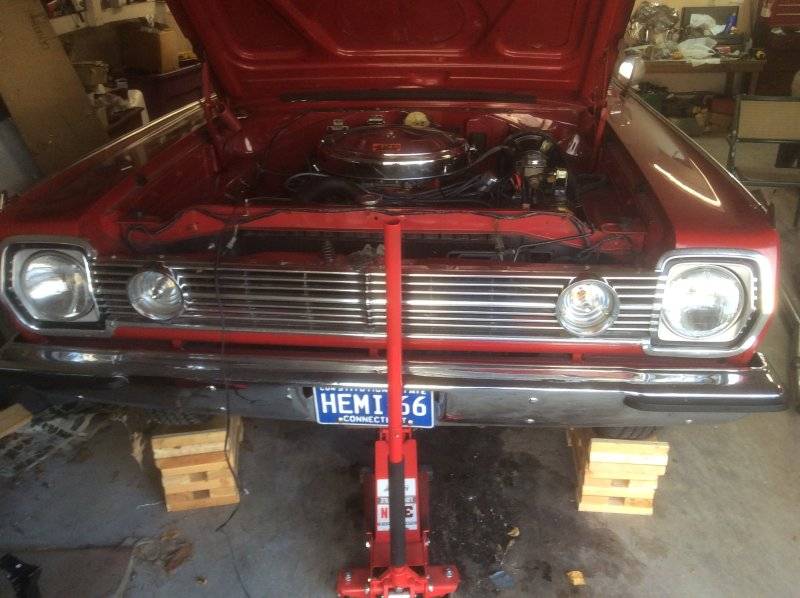

Have your car high enough to work under SAFELY, is the drive way level? Jack up both ends so the car is close to level. I jack the rear first, put jack under center rear differential and jackstands (JS) near front of rear frame rail. Make sure it won't slide. Then front JS's need to be tall 3Tons are fairly tall. I put them in the space between radiator support and K member and lower so JS's are on frame rails. Be careful space is tight so positioning is important. Blocks under front tires, but you need to jack under k member really high! You probably need to raise rear a second time.
When using a socket on a universal joint put a little tape around universal joint so socket doesn't flop around.

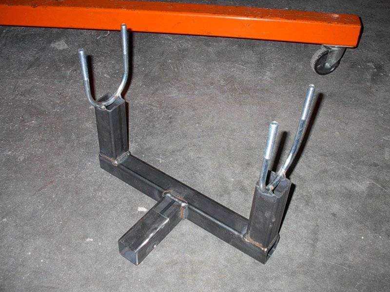

I'm old.....I'm lazy.....and I like my back not getting all screwed up when a rear axle/differential has to come out of a car that's up on a hoist.....
So I made this.....fits in the end tube of a cherry picker and makes dealing with the differential a "one-man" operation.
Gives the cherry picker something else to do instead of just taking up space....

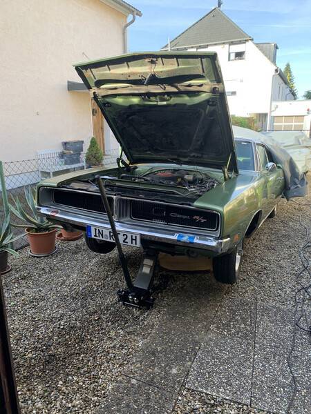

The longer i think about it, the more confident i get that i would do much better with a lift and concrete floor.
Or to put it differently that my current working environment makes me perform far less efficient as i could be.
I mean that's kinda obvious and i already knew that my driveway https://www.forbbodiesonly.com/moparforum/attachments/img-1170-jpg.1173671/
is a limiting factor but i think it actually limits me a lot more than i thought. (But yes it is level)
I do understand that other people can work very effectively in their driveway but i'm unfortunately not one of those. I mean i got things done so far but it takes forever and i hate working in this environment.
Yesterday i felt every single bone. intense. Unfortunately i cannot even use a mechanic trolley and things like moving the jack around plain simply sucks on this surface aswell. Pair that with space limitations.
Well i guess right now i just have to deal with the fact that some repairs suck and take forever (I'm also dependent on weather) at my current place and work towards a solution.
At the end i'm not only working in a driveway. I'm working in a tiny driveway that looks like a pebble beach. Not good if the repair itself isn't too easy aswell.
What i basically think is if the internal access (working room) of the car isn't to great it's best to maximize the external access (working room) by ideally having a nice size garage with concrete floor and lift.
This way you have the best possible access to the tiny targeted area. Obviously this wont give you much of an advantage when replacing a fan clutch or something like this.
