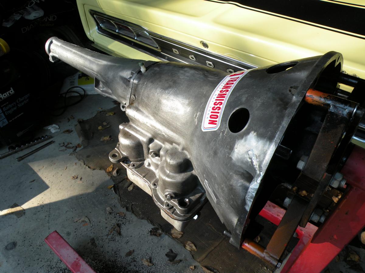

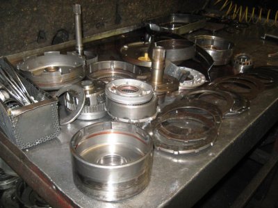

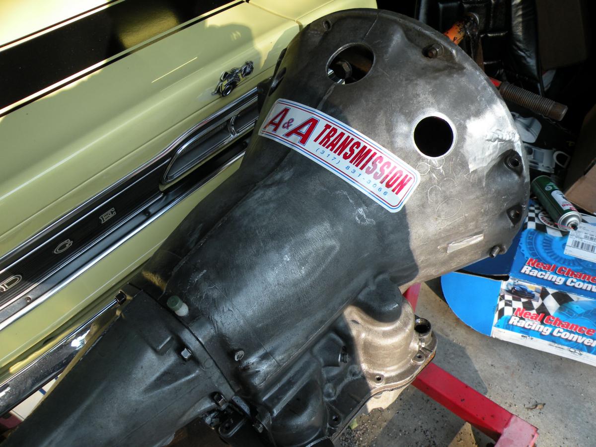

i got a new a&a trans for sale with all the good parts .let me know.aluminum drum, wide racing band, red altos,bolt in sprag. pm me. im in nj twice a week.
