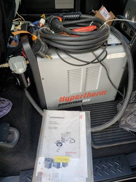

Thanks everyone for your input. I found a Hypertherm 600 at an estate sale this morning. It is a brand new, never used unit with over $200.00 in consumables. Came with all the manuals, etc. I know the 600 was discontinued in 2008, but from everything I read, parts/consumables are still available. I paid $900.00 for it. Looking forward to getting it hooked up and trying it out.
View attachment 1173932 Thanks everyone for your input. I found a Hypertherm 600 at an estate sale this morning. It is a brand new, never used unit with over $200.00 in consumables. Came with all the manuals, etc. I know the 600 was discontinued in 2008, but from everything I read, parts/consumables are still available. I paid $900.00 for it. Looking forward to getting it hooked up and trying it out.
We had a Hypertherm 600 it is a great plasma cutter. The models after the 600 had some struggles but that unit is perfect for what you need.
