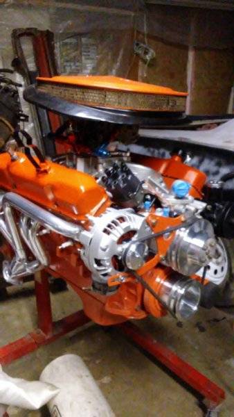

Been away for a while. Car in storage nice and warm. 440 at machine shop getting worked on. The engine builder asked me about exhaust. I told him that in anticipation of a big block, I had a 2.5" dual exhaust with crossover pipe installed with 40 Series Flowmaster mufflers, which currently sit behind a stock 318. Now my 440 build is mild, only going for around 350hp, with the 452 heads, and a final compression of 9.5-1. I don't own a set of b-body RB exhaust manifolds, and have been told that non HP manifolds are pretty useless. The HP units are very expensive and hard to find. So for my 1970 Plymouth Satellite, 727, 3.55 geared car with power steering, which headers should I be looking at? Doug's or TTi? Thanks all, as usual.

I've run the TTI's and The Schumacher Tri-Y's on many cars. Both good.Expensive but work well.The Schumacher are hard to come by and wait time can be months.TTI make a real nice shorty big block header and not a bad price.If you go that route order their down pipes that go with them,That way you can bolt them up without having to have pipes made to attach to the rest of your exhaust.

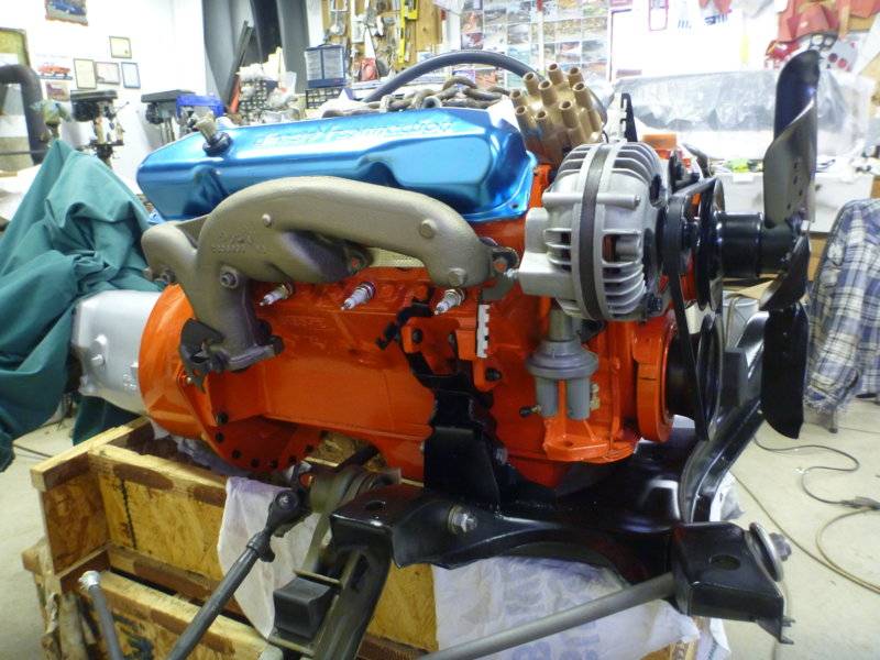

I like these "headers".... available any day of the week for $450 or less. Probably a couple sets for sale in the Classifieds right here on FBBO.

EDIT: Quick check and there's at least one set of 70/71 HP manifolds.. only a couple pages in in the classifieds.

For an engine combo like that, I'd be running HP manifolds hands down every time! I have 2" TTI's and in my engine compartment with power steering, its tight for sure. I hate headers but with the big stroker the car had, they are pretty much mandatory. My runner has a mild 383 and has the manifolds and I would never buy another set of headers for a mild or the manifolds even mid power street engine. I know so many guys that had headers and went back to manifolds so they could pull the #2 spark plug without a plug socket and wrench or bolt on and forget about them and not do maintenance and struggle. They are a must for big power, but on a street car with a street engine, I vote manifolds for ease of use and space and WAYYYY less engine heat. ANY B/RB HP manifold will work for you. There is not a specific set for an RB motor so they will all do the job.
