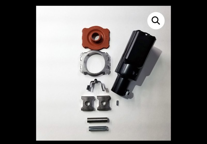

I’m just not too crazy about cutting the column shaft.
This “Bergman auto craft has an adaptor so you don't have to cut the column.”
They used to be good, until the son took over then the company went to ****. Besides, it’ll cost a lot to ship your core and ship it back to you.
Oh wow. I didn't know that. Is that a little shorter, is that how they solved that issue?
