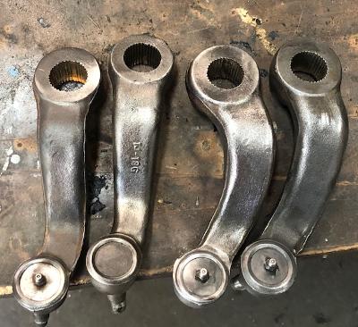

The pitman arm only fits 4 ways, three of them put the arm in a position that absolutely will not work. Realistically, there is only one right way it goes on.
Look close. There are 4 flat spots 90 degrees apart. You would have to be really drunk to install it wrong.

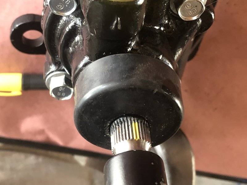

Thanks KD. Do I need to find the “high spot” of the gear box for centering?
On stock steering boxes, there is a flat spot at 12:00 when the guts of the box are centered.
With the Borgeson, you have to either rotate it full left then right to establish center or use a torque wrench to find the point with the highest torque resistance. Screw that....I just rotated the input shaft back and forth and counted the turns. I marked 12:00 with a paint pen.
Again, the stock steering box has a flat spot here and the coupler is matched to fit that.
What he said. I did the turn and divide too.
