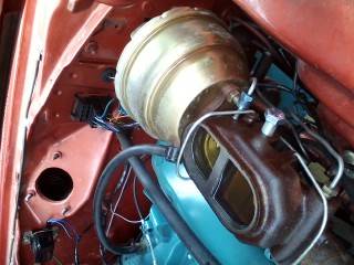

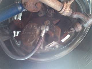

Post a picture of your calipers, mounted on the car...
Master cylinder. Incorrect piston size. You need to check the pressure at the caliper.
I bought a disc brake conversion from a known vendor. Their tech line was next to useless. They supplied the master.
Only through conversations with Cass at Dr Differential took me to the fix. I went with a master with a smaller piston and that gave me more pressure at the caliper
I also did switch to a dual diaphragm master.
This could be your problem assuming everything else is ok

If the MC is not providing enough fluid to the front brakes, but it is to the rears, wouldn't that cause the warning light to come on?
