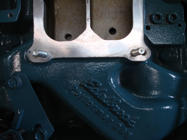

I'm wondering about the intake manifold. In the manifold directly below the carburetor there are two holes that appear to go in the EGR passage. I bought this intake used, without any installation instructions. Should those holes be plugged. The holes are not threaded. I checked on Edlebrock's website but didn't find much information. The holes are open to the EGR passage, which is the crossover passage from head to head (am I thinking right ????). The passage is open to the exhaust valve.
What are your suggestions.

I have no idea why their is holes in your intake, but I'd fix that. Regarding your vacuum issues, that about what can expect with a 108 LS. Since you already purchased a new booster, all you can do is swap out that cam, 112 LS would work out well and reduced the cranking psi especially since you have iron heads. Are you running 100 octane? Surprised if your not pinging like crazy at moment.
if you dont have adjustable rockers,the pusrods could be to long
I don't think those holes connect to the heat crossover. I don't think they go anywhere as long as the EGR stuff is not hooked up, which I think would go where those two pipe plugs are. I could be wrong, but I think that is the deal with Performer 383. I used one for a long time. Manifold vacuum did not change when I switched to another intake manifold.
Sound like a case of bad planing. Get rid of the power brakes and the loss of vacuum will not be a problem.
the holes are for exhaust gas recirculation. those manifolds came with a pair of block off threaded plugs. block the holes and recurve the distributor.
That's about right for that cam. Personally, I'd pull it out and run something else.

Thanks for the responses. I plugged the EGR holes in the intake and it did not make any difference on the vacuum. I have the 850 TQ on the car and now have the car so it will idle at approximately 750 RPM. Vacuum is only 5 at inches. Timing is set at about 10 degree initial and approx. 35 total, I will continue to work on timing adjustments once I get the car road so I can drive it. So far all adjustments are with the car setting in the shop. Car has not been driving in 2 1/2 years.
