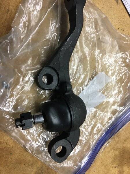

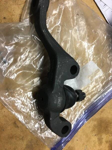

Question for all of the gurus! I got a complete kit for suspension rebuild and the lower ball joint bolt is a "little" loose in the lower control arm hole. It moves a tiny bit back and forth. When the castle nut is tight, it does not move.

Neighbor of mine who builds motors said to tighten it up to torque and then take castle nut off to see if ball joint stays put. It did not. It fell out. Hmm..

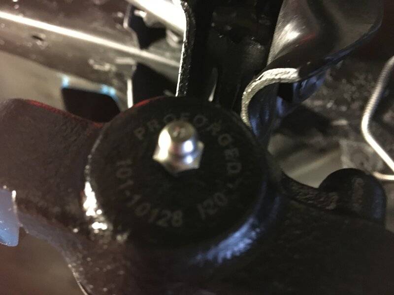

Wanted to give an update. I ditched the cheapo OSX lower ball joints and decided to try Proforged. They actually passed the torque and remove the castle nut and not fall out test. But of course nothing is perfect! The included castle nut has deeper grooves and it appears that the cotter pin hole is farther up the stud as mentioned by another member. But, the distance/compressed bushing height between the LCA hole and ball joint in the same as original on other side. So, I'm going to get a grade 8 washer or two and call it a day. Thanks for the help everyone!
