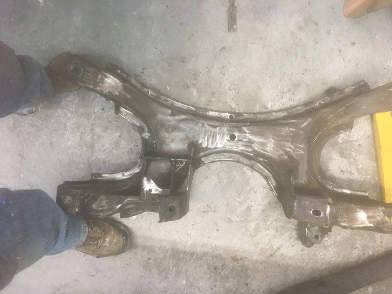

I did check the K-frame for sway bar bracket mounting holes and they are there.

K frame is dated too....Have you checked that?

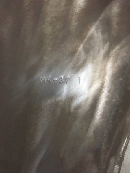

I found a number on the K-frame but it doesn't match anything in my 1968 Parts Index.
The number is MK-37-1.
Look in the front right above where the brace to the front grille support attaches. Should be a 3 digit code iirc.

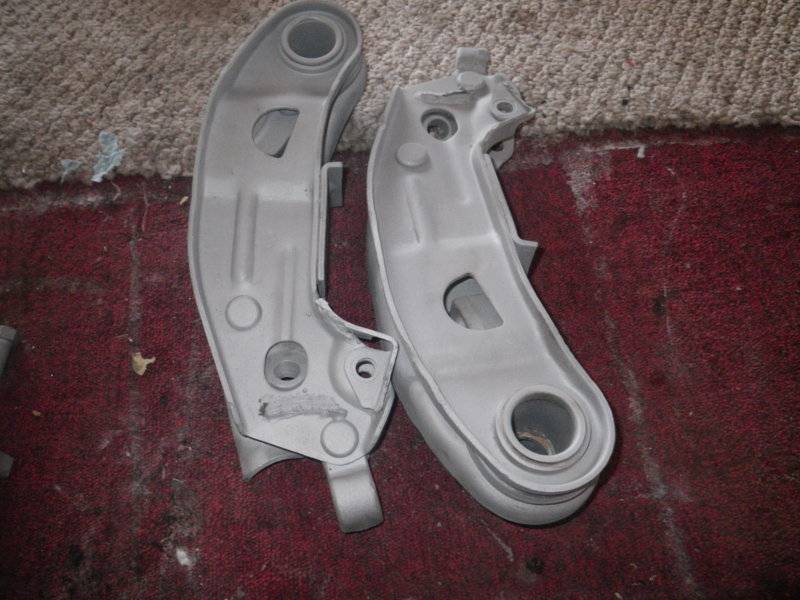

Apparently the sway bar mounts for the LCAs are available somewhere as a friend restoring an original 69 Hemi RR had non-original LCAs installed and he purchased the brackets and had them welded on.
Please ask him where he purchased them. This may be a good option for me as well.
i'll check with him today.
I heard back from him and he believes it was Hotchkiss Suspension.

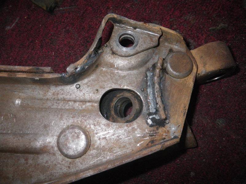

Okay, it appears that my lower control arms had the sway bar mounts removed. You can still see the upper portion of the bracket surround the hole and welded to the top of the LCA.

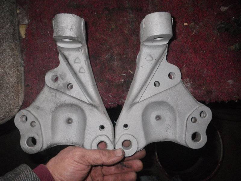

This leads me to believe they installed the disc brakes wrong (on the front) and they wouldn't clear the sway bar. So my next question is, can the steering knuckles be swapped from side to side in order to put the calipers toward the rear?

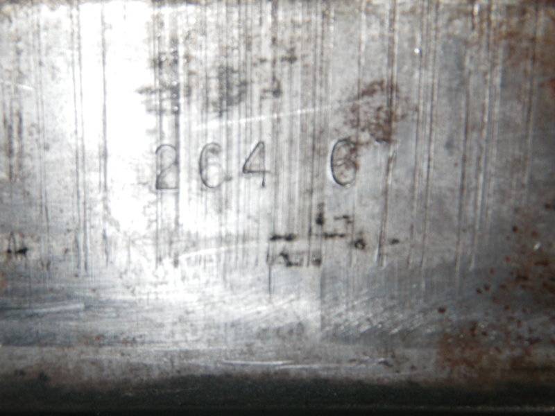

The only identifying marks I can find are the raised triangles. The lower ball joints look like they would center under the upper okay.
Anyone know if they can be reversed?
Have they got part numbers on them. If you can find those out you may be able to tell which is right and left?
Perhaps if you swap to the back you might just be putting them back where they came from originally. I am referring to the stub axles not the brakes.
