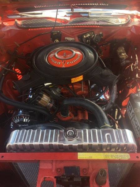

Looking to replace my aluminum rad in my 71 rr with a factory looking aluminum rad with both inlet and outlet on the drivers side like the oem radiator was and a factory shroud can be used on it. My question is im looking for rad hoses for it don’t want to spend $70 for a hose with mopar part numbers on it. Im looking at this lower hose has no spring but lots of good reviews. Is a spring needed? Continental Belts and Hoses 60659 Continental Molded Radiator Hoses | Summit Racing

New oem style radiator is in with bottom hose spring installed. Thanks for the advice!
