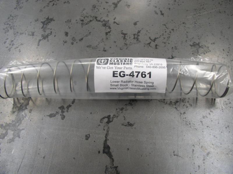

I have just started the teardown of my 69 Road Runner for an engine swap, and realized I didn't have a spring in the lower hose. For some reason these are hard to find. I ran across one that fits perfect although it is made for a small block Ford - I just threw away the sticker and nobody will ever know lol. 13" x 1 5/8" stainless steel $5.95 each. The only kicker is that the minimum order is $15., so you have to buy 3 and pay $7. in shipping. Bringing the total to $8.28 each including shipping.

I got free shipping on the small block one that's 13" (EG4761) which fits perfect, the big block is only 8" (EG4762).
