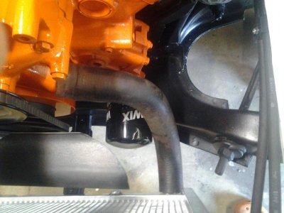

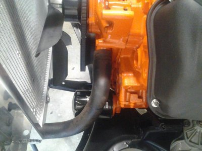

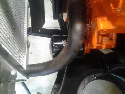

I actually ran into the same problem here as many of you and I had a water pump laying around out of an old chevy with bottom radiator hose on it and it looked like the routing I needed and the end sizes are the same as mopar 1 3/4 ×1 1/2 so I tried it and bingo fits really nice just had to cut about 2 inches off the radiator end of it and it evens fits around my wix 51515r long filter with out rubbing and the filter will be easily changed without hassle now just going to get a new one the same part number its a gates 20559
