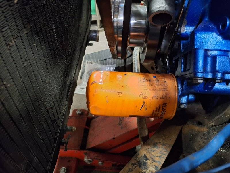

I have a driver side outlet on water pump housing and a passager side lower radiator. Any body know of a hose part # with a u turn to a long then 90 degree? Seeing if anyone can make it easy before I go flex or universal.
963 radiator
400 b
Thanks
John
Have a radiator shop switch the outlet to the left side. Unless the wrong water pump housing has been installed-if so switch housings.
Mike
That'd be a drivers side pump INLET, but no you do not want a hose snaked under to the passenger side. Get the radiator changed as per ^^^ or buy a newer model passenger side inlet pump.
I have an aluminum radiator that bolts right in a b-body to the factory mounting holes, and the lower hose is on the drivers side like it should be.
