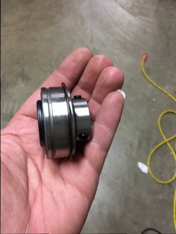

ER-16 bearing. Find it on eBay for about 6 bucks. It has a 2' od and a 1' id.
Here is the bearing.
Just did this yesterday , the factory plastic bearing is 90.00, the er16 was 6.99 shipped.
