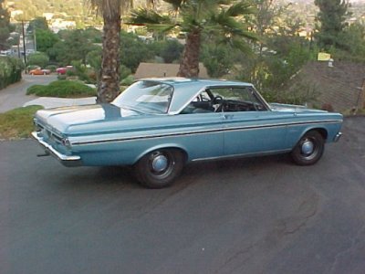

I used blocks on mine, I like the stance a little better.
