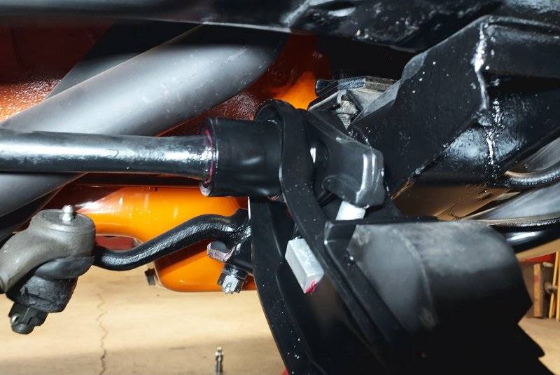

Here is the suspension setup. Currently it's stock lower control arms. The uppers are a set of tubular from firm feel. No sway bar on the car right now.
Sorry for the delay got busy the last couple nights. Below is a picture on what I am talking about.
Here's a picture of the torsion bar one flat out of position. The red arrows are pointing to white lines that would normally line up. Look at the adjuster arm. One flat the opposite direction from where the lines line up, the adjuster arm would be way down inside of the control arm.

I thought it was impossible to be 60 degrees off with a bar in an LCA.. BUT, there ya go. That said, if you don't notice that the adjuster ear is heading for the moon... well...

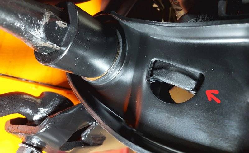

This is one flat down too far. The red arrow shows where the adjuster arm is. You can't even install the adjuster block and bolt into the control arm.
The only flat that works and what it looks like.
Yeah that's what what it looks like on our car. I guess the adjuster needs to go super high then. I'm not the one who installed these or even knew it was an issue but here we are.
