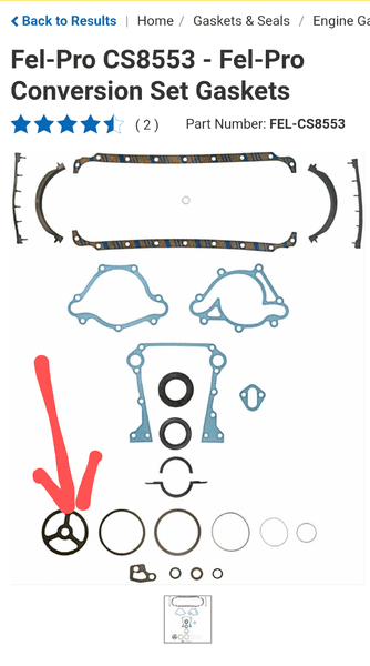

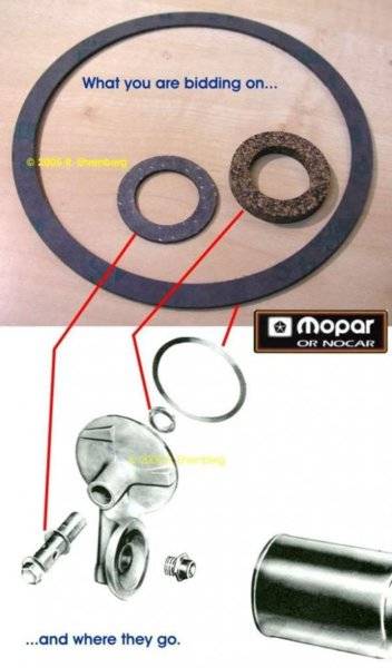

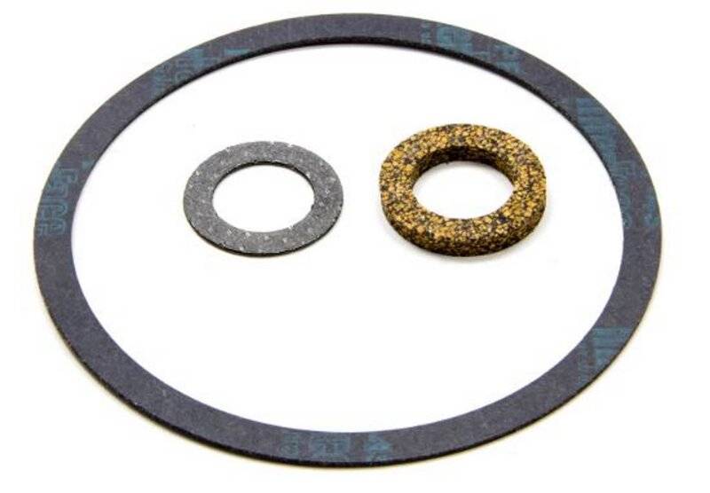

Here's what the plate and gasket look like.View attachment 1136478 View attachment 1136479
That is the one I am talking about. It is incorrect for a normal filter plate. I had the guys next door to me at work have the exact same problem, and they had used the exact same gasket. You should have used the third gasket (two to the right) of that one. The one next to the one you used (second one) is a smidge larger in diameter, and have not seen an application yet to use the larger one.
I just pulled that picture from Summits website since it had the gasket that I used in it, it's been so long that I don't remember if the kit I bought had the other options? The one I used fit the plate perfectly and sat down in the machined recess as well? Like I said before putting it back in I put the plate in dry and it touched on the I.D and O.D surface so one would think it would work? It's sealed now with that gasket, ran it long enough to bring it up to temperature, oil pressure looked good, no leaks? I'll keep an eye on it.
