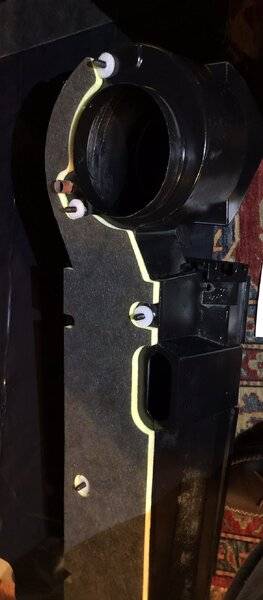

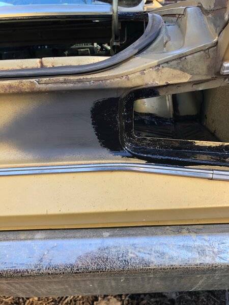

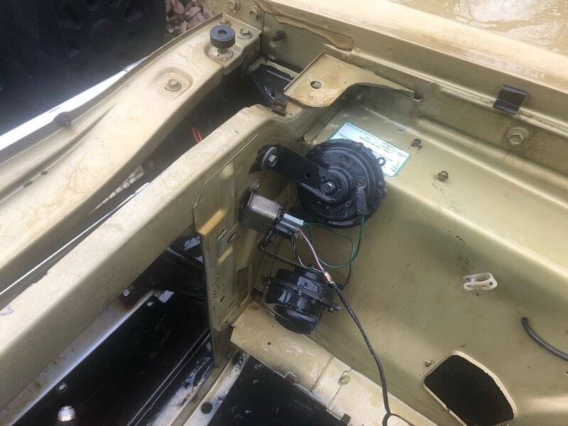

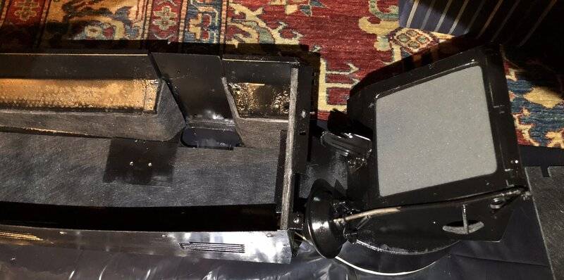

Mid week, winter weather. Got to make progress somehow. Glueing in the air box insulation by the fire. Made more of this in my mind than it is. Lay it out, spray it and stick it.
2 pics.
CFA29F21-CF49-48A5-B22D-A6A9C9245D8A.jpeg 02CC944E-5CF2-4717-924F-DB8ED70F436C.jpeg

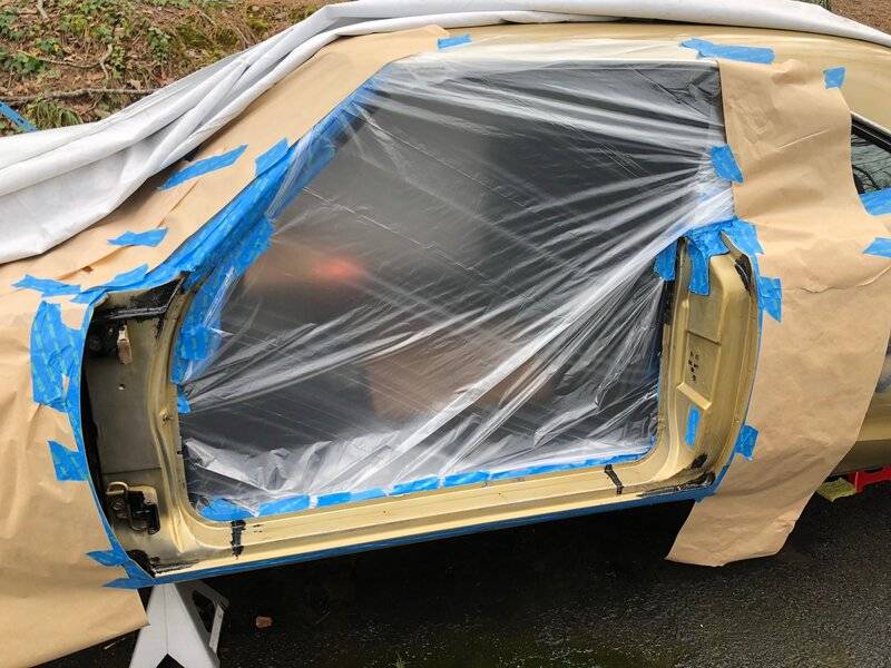

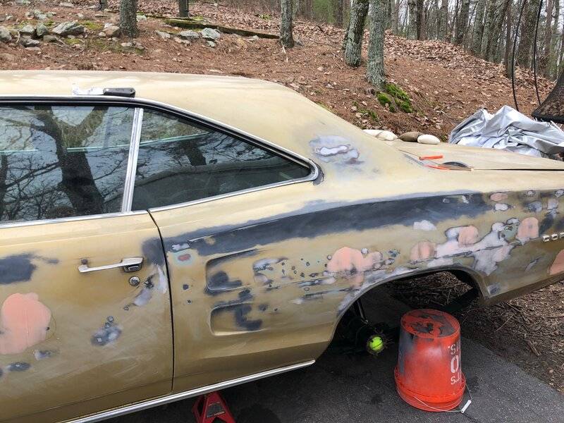

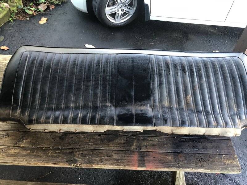

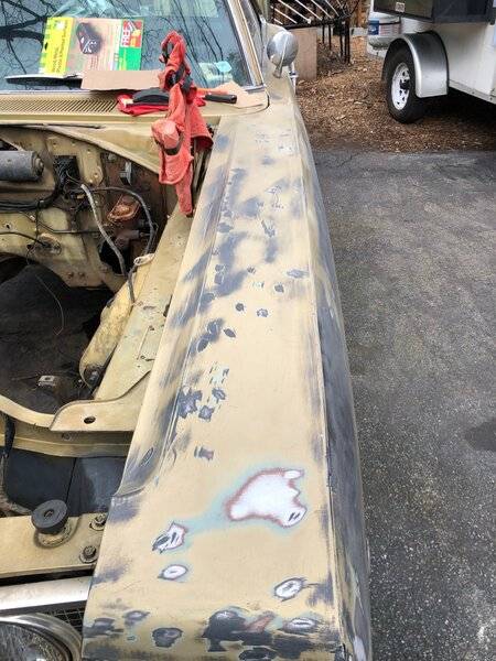

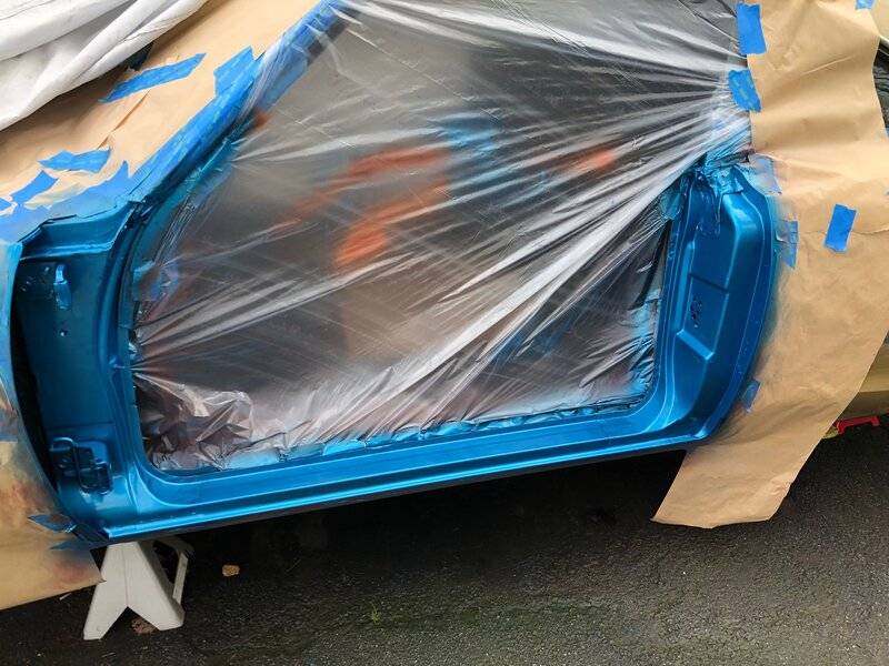

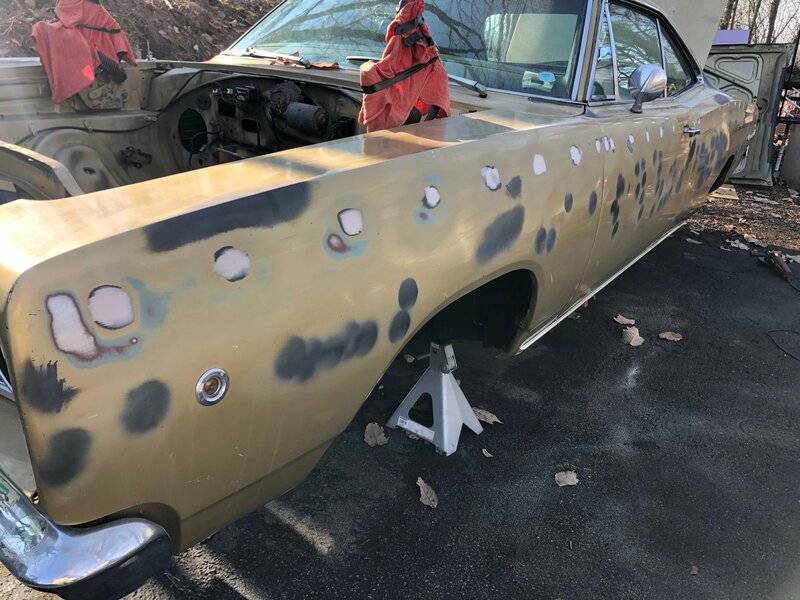

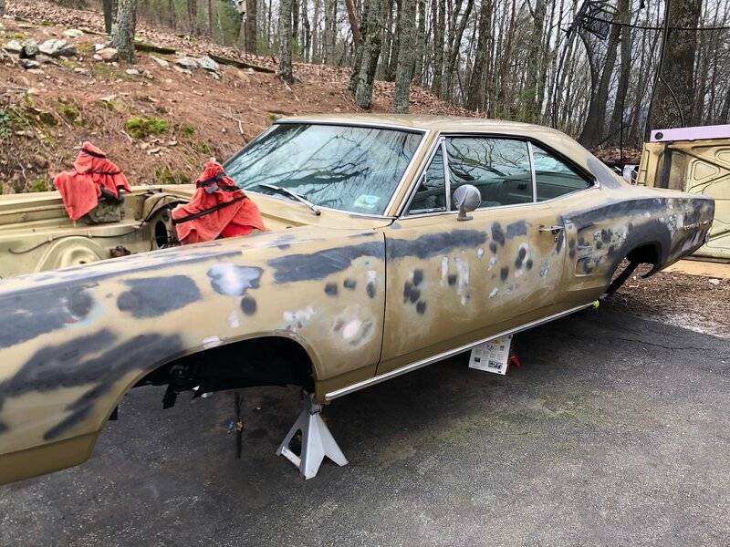

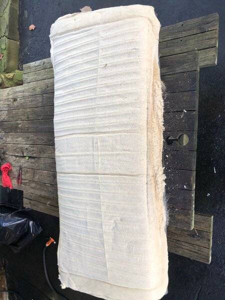

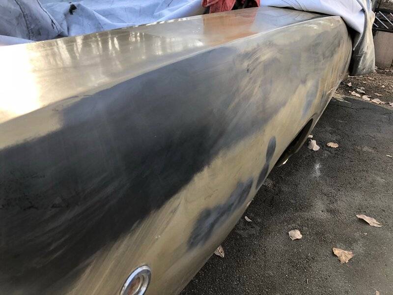

Finishing up the old trim holes. Sanded and primed to look at the finished lines. Not bad. Also working rear seats reupholster.
36A76AE5-83F3-4F19-8CB4-53D63AC9FD66.jpeg 4850F813-8E0E-4074-81FF-CE468FE8A282.jpeg 438B43BC-EA1C-46F8-862F-27A9339CB22D.jpeg 90274F6C-4CE7-454F-B0AB-0A6081361CD5.jpeg

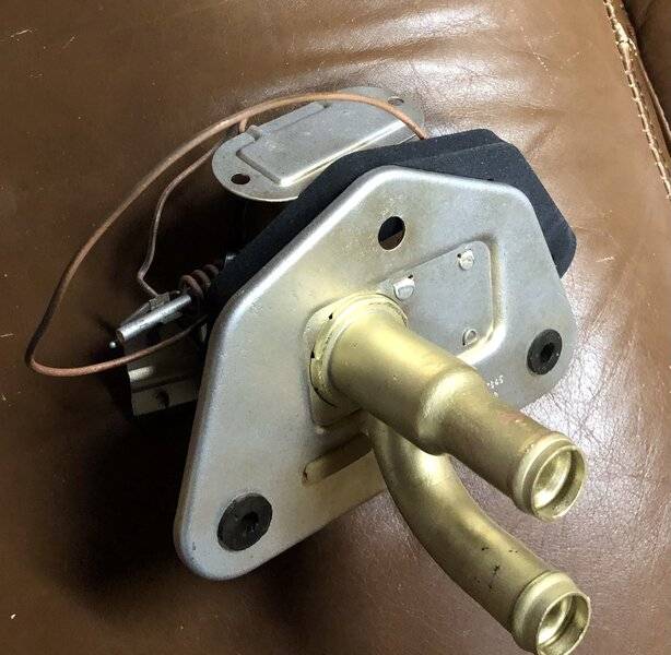

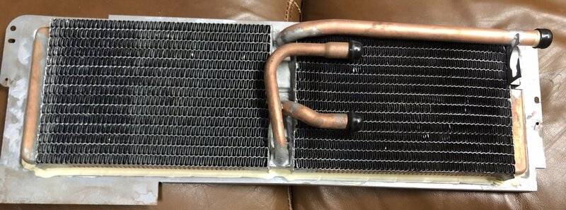

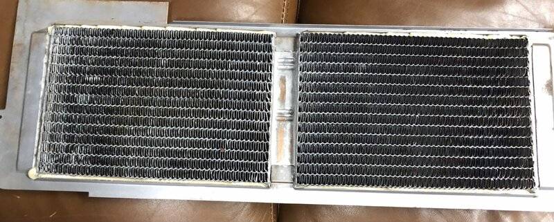

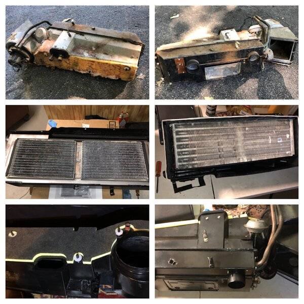

Many thanks to Glenn Ray Radiator on the heater core and Joe Hudacek on the heater control valve.
A2597976-B1AC-4B2B-AE76-E3BFFF54D2F7.jpeg 5B61D4DB-2863-4D31-A9F2-98A71FBD68ED.jpeg 2AC23AD6-1AFB-47C9-8CE5-E760FCC08782.jpeg 345813D3-0F52-4EF4-945F-9DD1EB8FC303.jpeg

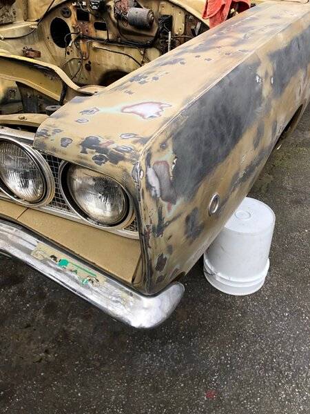

My brakes are missing in action and my gas tank appears to have gone to outer space so I have been reduced to body work waiting on parts. Lots of work ahead.

One air box. Stick a fork in it. I understand the send it out and get it back price now. This thing sucked up some hours.

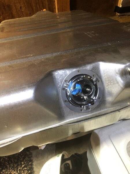

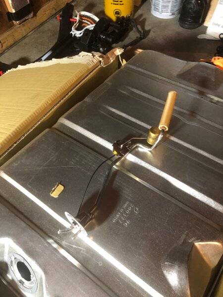

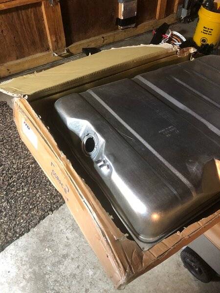

The space ship landed with the gas tank. Fill tube gasket in, sending unit in, but of course the new tank straps are M.I.A.

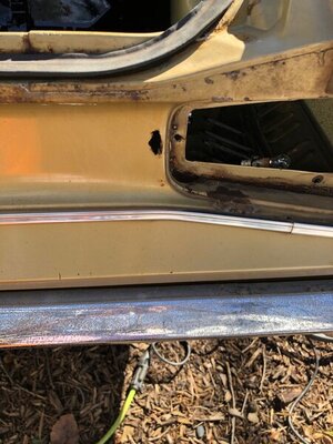

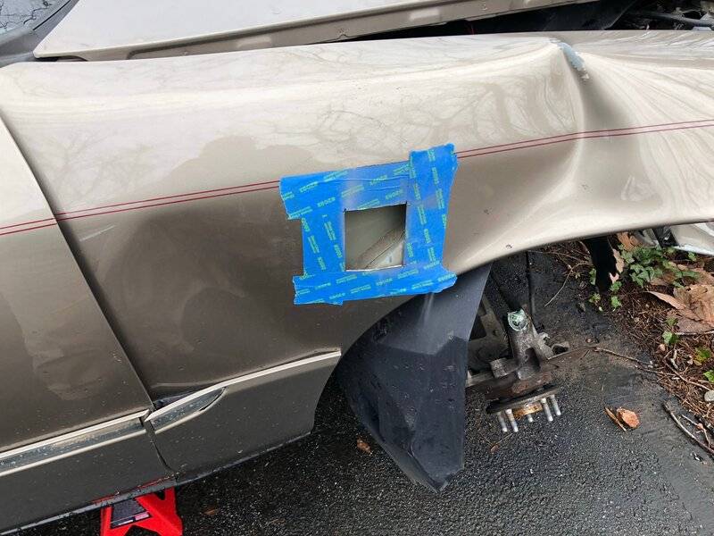

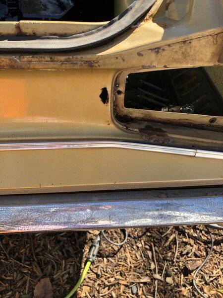

Few extra holes to close up.
A68D4CC8-EBCB-4AEB-8C86-D4B3CCAD1C10.jpeg 462BAF62-B4C6-4A6A-BB19-BB8CF32046BF.jpeg

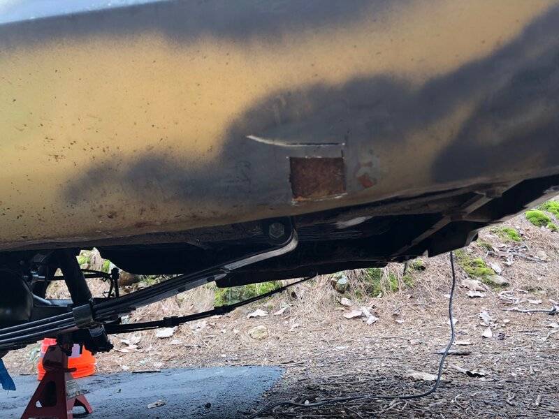

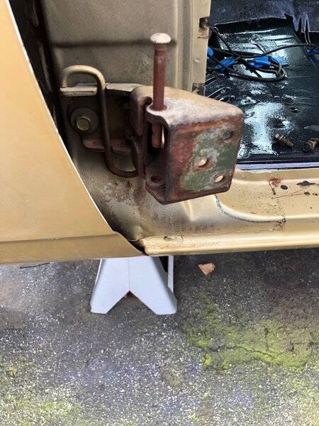

Sometimes a wrecked Ford in the yard comes in handy. Thought I had one patch to repair, lower quarter is trashed. Both sides will need sub quarter patch panels.

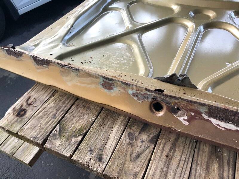

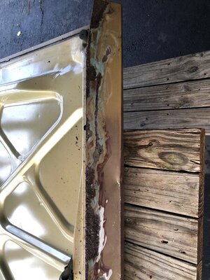

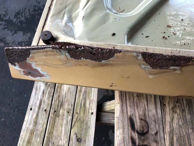

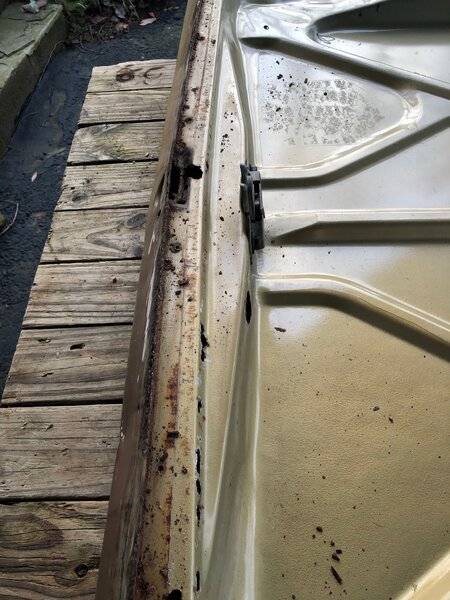

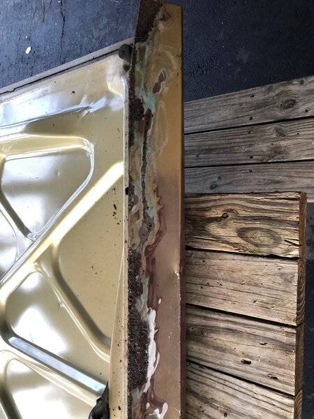

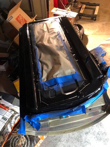

Trunk is done. Made an executive decision based on man hours vs dollars. The lip is done and it needed to be de-skinned due to the rust falling internally. Fiberglass replacement inbound.

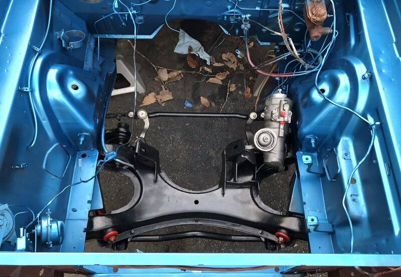

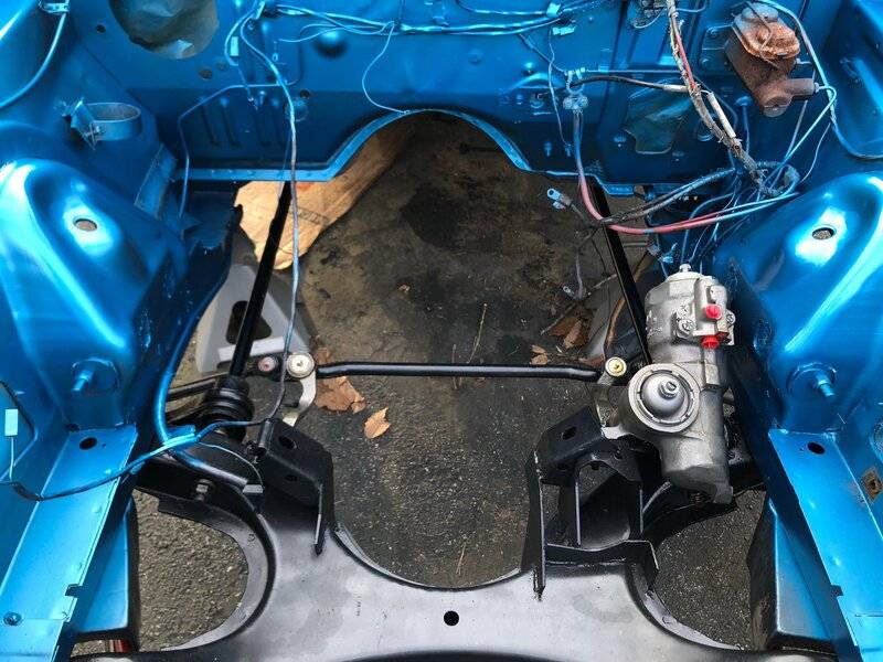

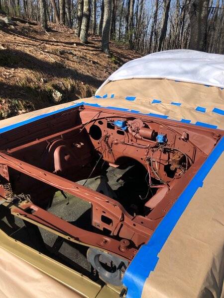

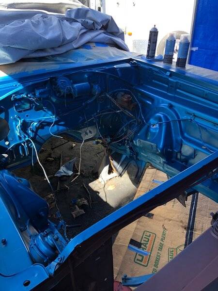

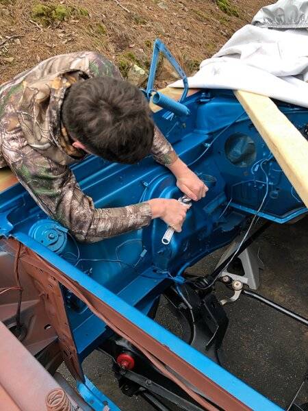

Prepping for engine drop and need the K frame back in.
A75E6B76-A5B3-4DDB-919F-D7A4F145BFD7.jpeg 4D9F0B76-0451-40CB-B5B3-7B809857B893.jpeg 78C8BD3F-9624-4222-B489-B02DB251CDCB.jpeg E84F9CFA-8182-48D5-AD0D-813B245511AD.jpeg

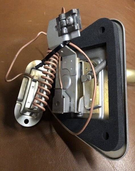

Easy way to get boots on torsion bars. Cut a funnel to size. Grease.

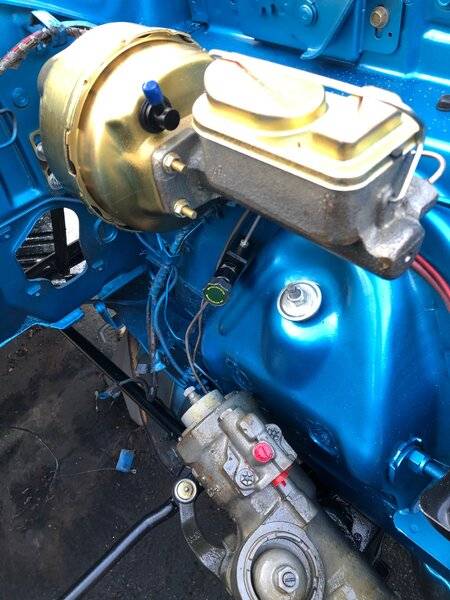

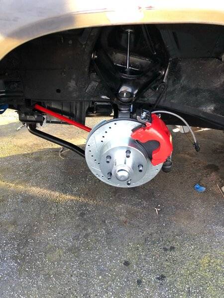

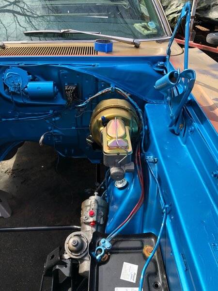

Power brakes. New lines run to distribution block. Proportioning valve cut in between master cylinder and original distribution block.
BED69F4C-FBC8-452C-B634-F1258D14E7E0.jpeg 99127584-AA9C-4DD9-AE76-9D718588A522.jpeg
