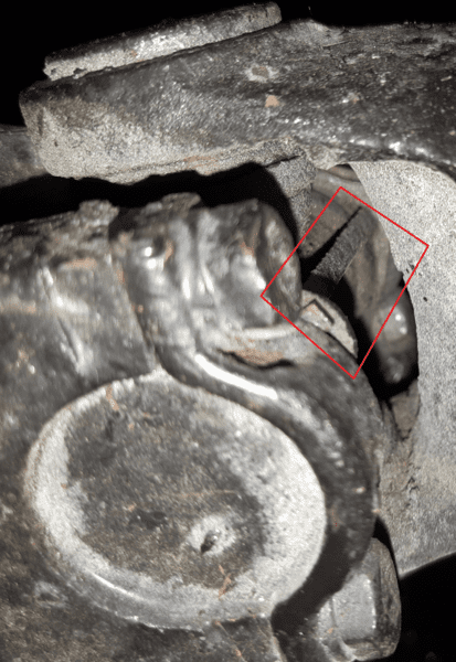

Thank you for the replies @ 33 IMP and 69Coronetrt. I just happened to check the rear u joint yesterday and I found that the gear ratio should be 2,76. The rear end is a 8 ¾ 741. So that all matches what you said. The only uncommon thing I noticed ist that two of the inner clips on the u joint have an extra „eye“ where a pin (L shaped on both ends) goes from one side to the other (see photo), The u joint has „DETROIT“ written across it. Is that common?
