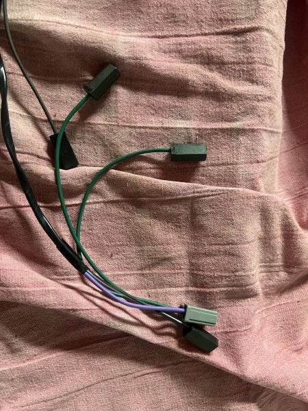

I’m installing the M&H Engine Harness on a 69 GTX I have the Shop Manual, the Color coded wires from M&H doesn’t match the Service Manual, can someone tell me where these wires go,Thanks
Well the last one looks like the horns, horn relay and windshield washer motor. The first one looks like water temperature, coil. Would have to go out and look at my car for the rest.
You have the harness just sitting there ? Not sure why you say it doesn't match the schematic. A Mopar BB harness is actually quite simple to hook up without a schematic, it sorta lends itself to go to the components.
I can’t tell what the manual says, but the colors there are the right ones used on all Mopars, matching the standard applications for each wire.
Blue with eyelet, +coil up to 69
Purple with bullet angled terminal, temp sender
Big eyelet with black 12 gauge wire, alt.
Purple wire coming out from that, feed to horn relay
Green with packard plug, alt field
Brown with Packard plug, washer
Rest of plugs… horn relay and horns:
-purple and green T conector… in and out +s to horn relay
-greens… horns itself
-black… horn switch from steering wheel

Thanks Nacho really I appreciate that, I’m new to Mopar’s and got this car in pieces, been doing a lot of research to put it back together, almost ready to start it up, Thanks
