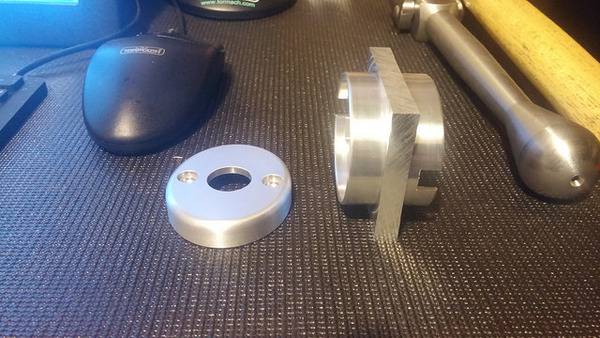

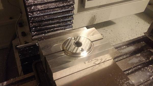

So I've machined a few things for my dad in the past and he kinda new what I did for a living. I got my mill at home and he saw what I can do, So one day he stopped by and he dropped off a bucket of parts he wanted machined for his Chevelle.

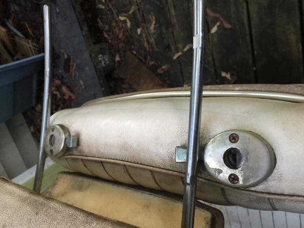

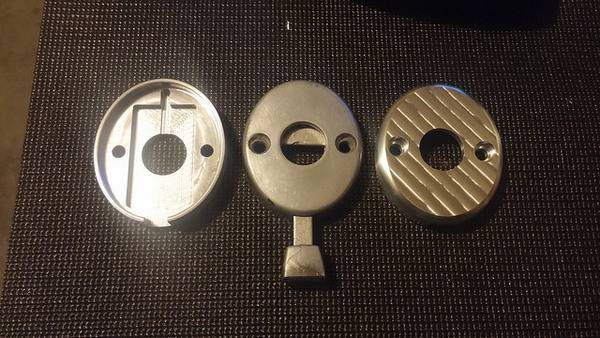

He has a 70 Chevelle and the first part I started making was these headrest buttons. The originals are chromed plastic. I started making them out of 6061 aluminum.
Eventually I'll get to my Charger but thought I would show some of my work.
The original is in the middle, the chrome was pealing off to my dad spray painted it years ago.
My buddy has a bridgeport - and I envy the work that he can produce form it . . . so you're lucky to have a mill at home ( that's a dream for me some day ) . . .
Nice looking work . . .

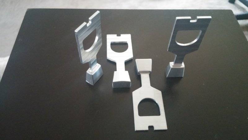

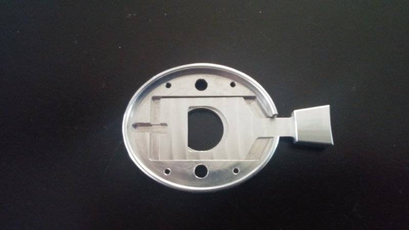

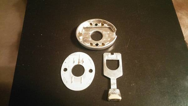

Finished the housing of the headrest locks, added some #2-56 tapped holes. Decided to polished them a little, I should have tumbled them first. Just have to finish programing the center button.
The original plastic lock disassembled.
Also just 3D printed the backs.
Almost done, buttons machined, back printed, shim printed, just need small #2-56 screws to put it all together.
