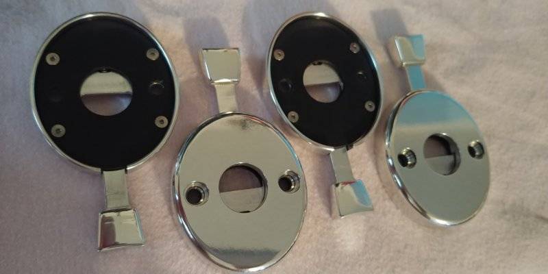

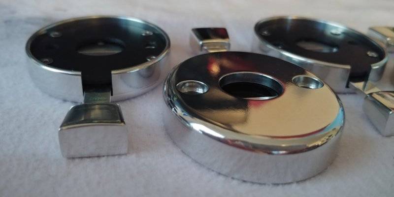

Very nice work! I’m impressed!Finished, all assembled and ready to go.

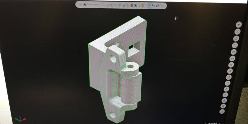

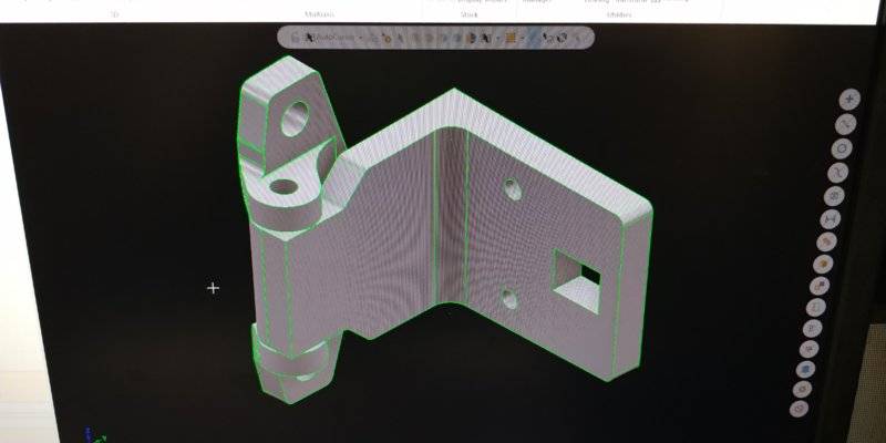

Thank you. I reverse engineered the hinges too the original dementions. I was thinking of making them out 304 stainless but started thinking about 7075 aluminium, but wasn't sure if it would hold the weight of the door.
Then I saw some aluminum corvette hinges (but those are fiberglass), looking around more I found some for 70-78 Camaros. Then I found an article about a auto manufacturer experimenting with aluminumdie hinges. They used 6068 witch supposedly has 91% of the same properties as 7075. They found that the aluminium would work if they added another .100 of material around the hinge pin.
With that in mind and lots of 7075 laying around I just modified the original model increasing the thickness to .437 and figured what do I have to lose. If they fail I'll go to 304.
I have it all programmed but don't have the estimated time right now but I'll check it tomorrow at work.
There is a BIG difference in machining those two different materials. 7075 alum. is a breeze. Tooling cost could drag you down with using stainless unless you already have that figured with how your machine programming works.
For manual machining, (for my estimate)I would add 100% actual machining time for 304 stainless.
With the high speed toolpaths and machining at full depth, the tooling last longer and will speed things up.
I rough everything with one endmill leaving .01-.02 of stock then start the finishing work.
I love 304 so I'll make 2 sets one 7075 and one 304.
BTW That square hole shown in your post images is a time and money killer to get correct in real life.
I have forty years of stories about engineering/design conflicting with practical reality. I have made square holes because they are called out and not needed. -The customers have been both pleased and sad at the same time with the bottom line cost.
One-off (or even short production) of a part is a collaboration.
Mass production (however) of a design is another matter and not a part of my world.
I modeled it to the original hinge but wasn't planning on sharp corners. There's no way a 3/8-16 is going to need to get into that corner. I'm using a 1/8 endmill to finish the inside leaving the corners with a radius. But if I want it to look close to stock and need sharp corners i could use the wire EDM at work.
