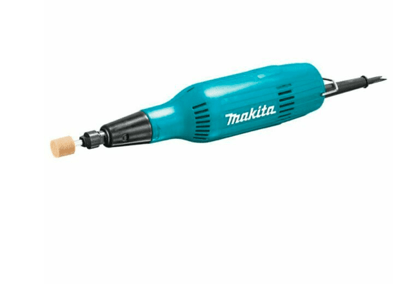

Sam, what's an "end grinder"?
Probably an ancient term first learned from my Grandfather. Some call them pencil grinders. End, as opposed to Side
