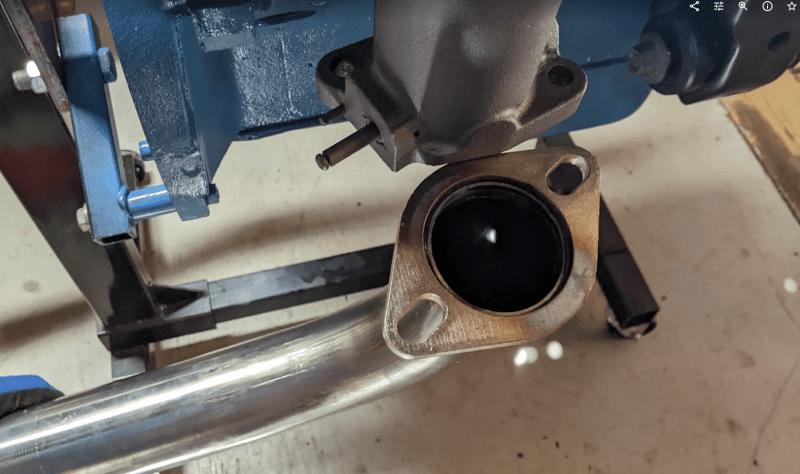

I ordered Magnaflow Manifold Pipe #19304 for my 73 Roadrunner with a 440 but the angle of the flange on the pipe is different than that of the manifold. Is this the wrong pipe or was there more than one manifold orientation? This is teh right hand side, the left alignment is okay.
Any ideas?

Are you certain of the manifold numbers being correct for the application? Make sure and call Magnaflow. We can't fix it.
My 73 is in the same position...Looks to me they welded it on backwards.
Defiantly the right part number ordered and received as per the box. I contacted Magnaflow and they asked for pictures but once he got the pictures I lost the connection and couldn't reconnect after that. I'll try again tomorrow.
Thanks for all the replies, I'll let you know what Magnaflow says.
The Magnaflow's are for the the factory "log" manifolds, not the HP manifolds. To get the correct head pipes you need to go to TTI exhaust and have the serial #s of both manifolds for fitment.

Okay, yes this is a HP motor so that makes sense.
So one more question here, if the flange angle is corrected would the pipe fit or is the connection point different from the log style to the HP style?
You may want to check the comments section on Summit about these pipes, as there are multiple complaints, anything form shifter linkage problems to clearance issues. They may be made to "work" with your application, but I'm not sure it's worth it when the TTI's WILL fit, for about the same price.

Hi Scott, I got the Magnaflow and it does not fit the HP manifolds without doing a lot of modifications.
Maybe see if a local exhaust shop will make pipes for you if you don't want to try the TTI pipes.

I’m a bit late reading your reply. The Magnaflow headpipes arrived today. I put them up in place on my HP manifolds and they seem to fit fine. I called their tech support and they said the clocking position of the flanges had been corrected. I’ll post again as I complete the rest of the kit.
