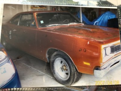

They are most likely not original as my Super Bee was restored by the second owner (I am the third owner) and it had was in the World of Wheels car show in the 1980's sporting an acid bubble paint job, tuck and roll interior and shag carpeting. I have pictures of the car before it was repainted and put back to original and it had old crusty steel wheels on it.
