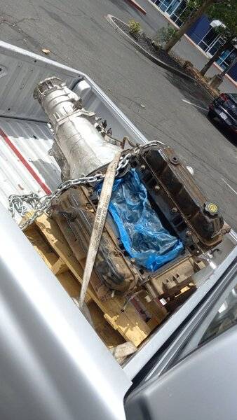

I have been been meaning to swap out the sloppy old 360 i pulled from a motorhome thats currently in my cordoba for a while now. Took a trip to the junkyard with low expectations. They wont let you bring in batteries and jumper boxes so i snuck in a motorcycle battery under my tools with a compression tester. I found a nice ram 1500 that was rolled so i pull a plug and hook up the tester. The keys were inside so i checked the milage, 105k. The battery i used has 200 cca so it barely wanted to crank. The damn motor fired up on the first crank with the compression tester in running on 7 cylinders. Didnt want to get kicked out so i shut it off and yanked her out. Not an ounce of carbon or sludge when i pulled the intake the motor was spotless. As an added bonus the transmission was a brand spanking new rebuild so i took that for my cousins truck. 50% off all parts at the yard this weekend so i got a motor and transmission for less than $300. Im pretty stoked.

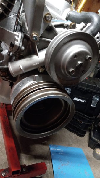

So i know the converter has to be used with the new engine. What about the harmonic balancer can i take that from my old engine so i can use the v belt crank pulley?

So im pretty ignorant on this subject. By oe do you mean to use a very early magnum dampner as these are the only years that have an option without a one piece dampner/pulley? If i did get the balancer from summit is that something i could do myself or would i have to get it setup by a builder?

Thank you. My question was specifically was what year of magnum motors came with a balancer with threaded holes that would work with an early crank pulley 92'-93'? And if i buy an aftermarket balancer with seperate weights for different engines how do i go about installing the right weight. Does it bolt on through the pulley holes at any location or is there more involved.

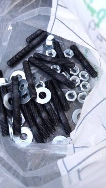

Pulling out some broken bolts and cleaning up all the bolt holes with a tap today. It got me thinking, since the intake bolts are verticle would there be any down side to running studs and nuts instead of bolts?
There is no problem running studs....however....adhere to factory torque specs or perhaps consider even less torque than specified, as long as you're able to make it seal. Reasoning: The vertical bolt arrangement causes the intake manifold to force the heads apart from each other which is not really desirable.
Also, the manifold may be very difficult to R&R in the future because of the studs. For this reason I personally would not use them but it is a judgement everyone should make for themselves.
