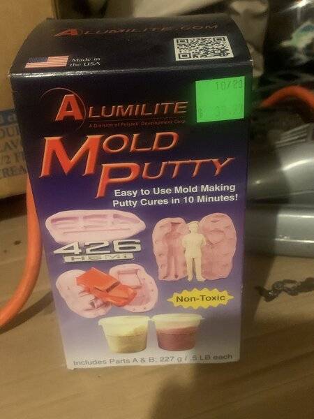

Try this stuff. You may need a couple. Buttt…

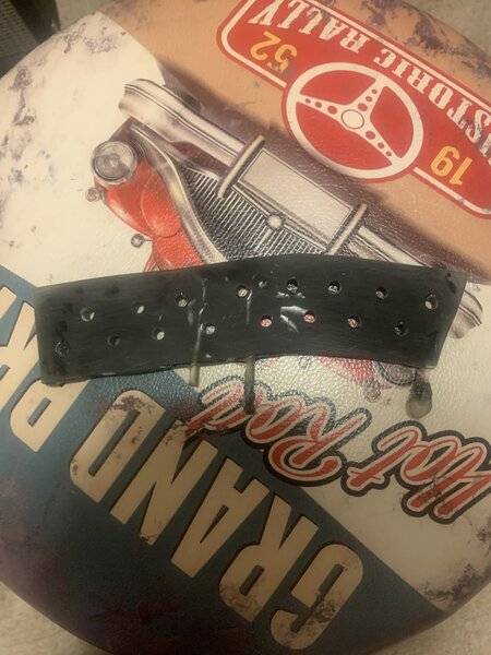

I did the mold then pulled it away from the original. Then made a test piece from the mold , seemed to work then made the actual item.
