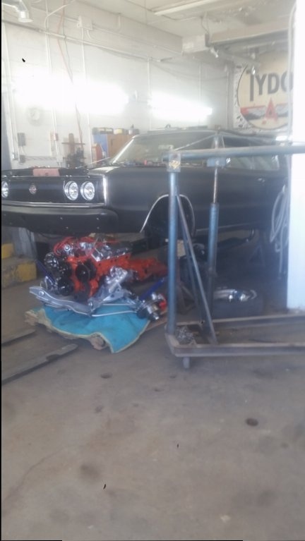

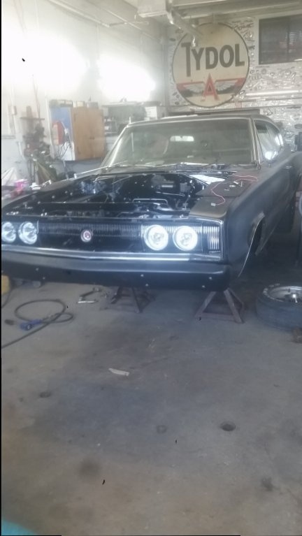

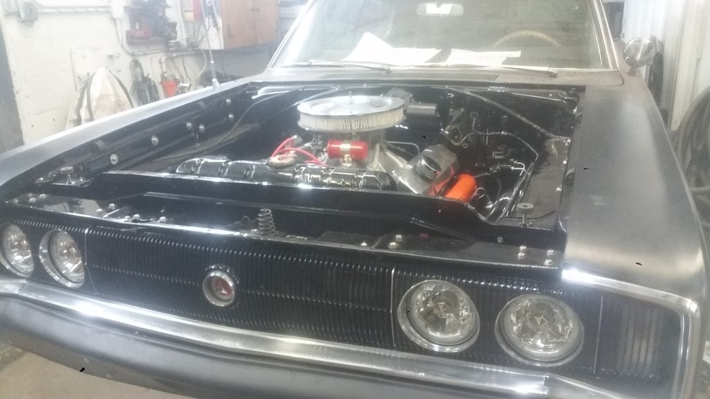

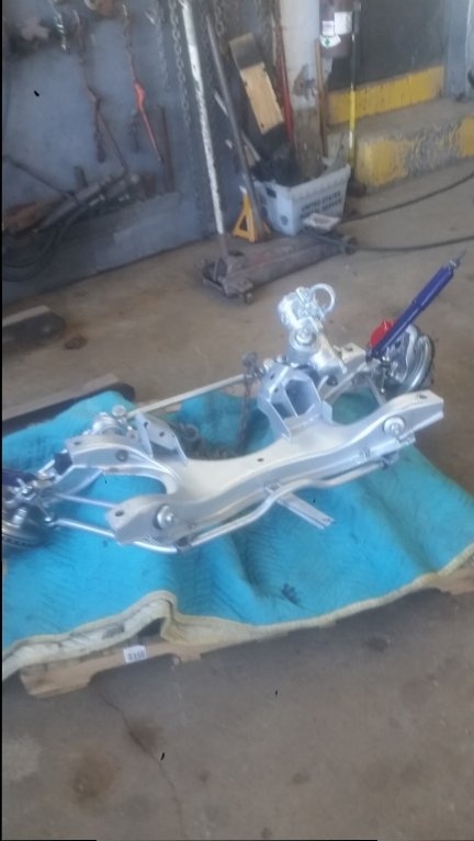

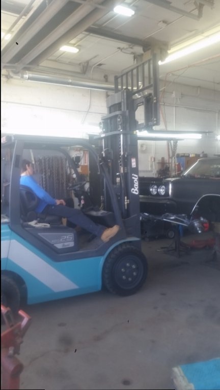

I'll let the pics do the talking.

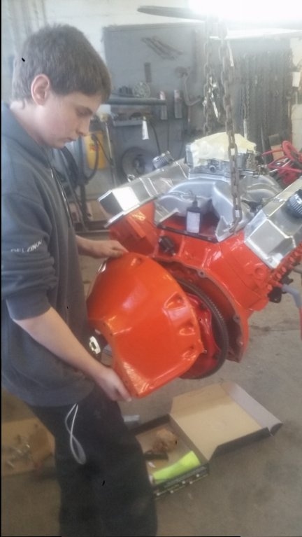

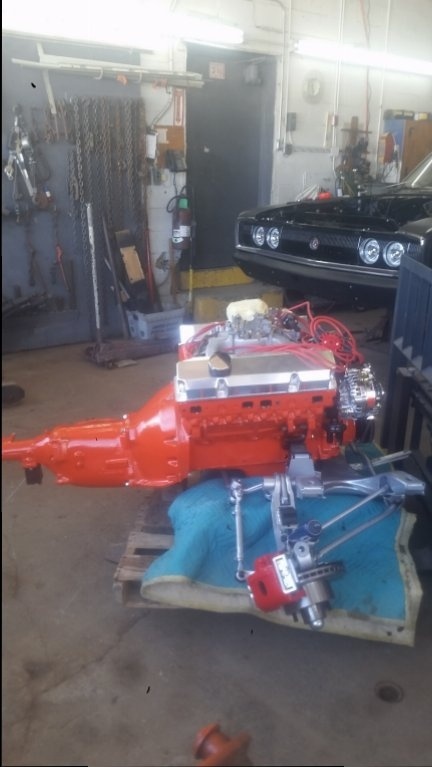

That's a 440 with whiplash camshaft. 4 speed overdrive. 1975 a833 the only year cast iron o/d. Brewer's hooked me up with the front bearing retainer to fit the bellhousing. Plus the fork, pivot, clutch, flywheel and some other odd n ends.

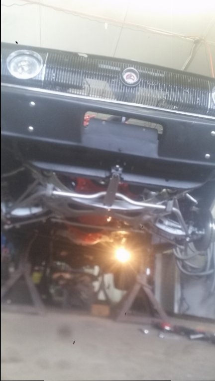

PST front end kit. MBM disc brake kit. Pypes exhaust will be going in soon
