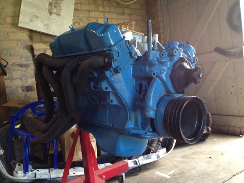

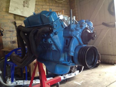

So here's a bit more, I picked up a recent rebuild 440 from a mid 70's C-body from memory. Unknown cam, but it all looks pretty stock. Not too stressed, as I'll tweak it down the road, right now I just want to DRIVE! Haha.

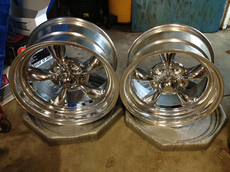

Also picked up a set of rims for a good price. I was going to wait until near the end, but when an opportunity pops up, ya grab em! So Torque's 15x7 front 16x7 rear. I'll wrap them in some raised white letter tyres. Also going to keep the steelies, paint them satin black and use them as well. Have a day2 and day 1 look!

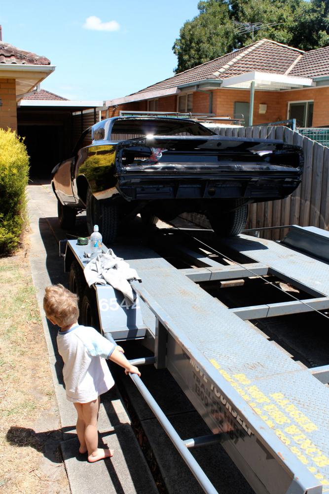

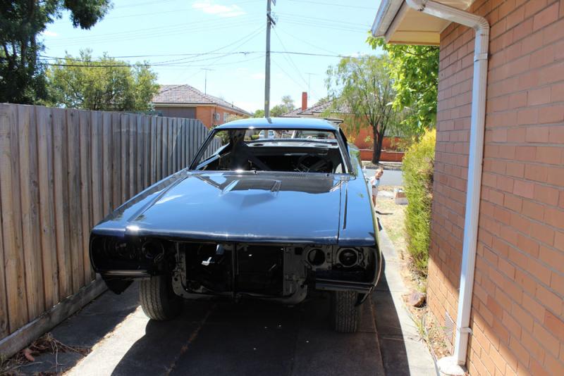

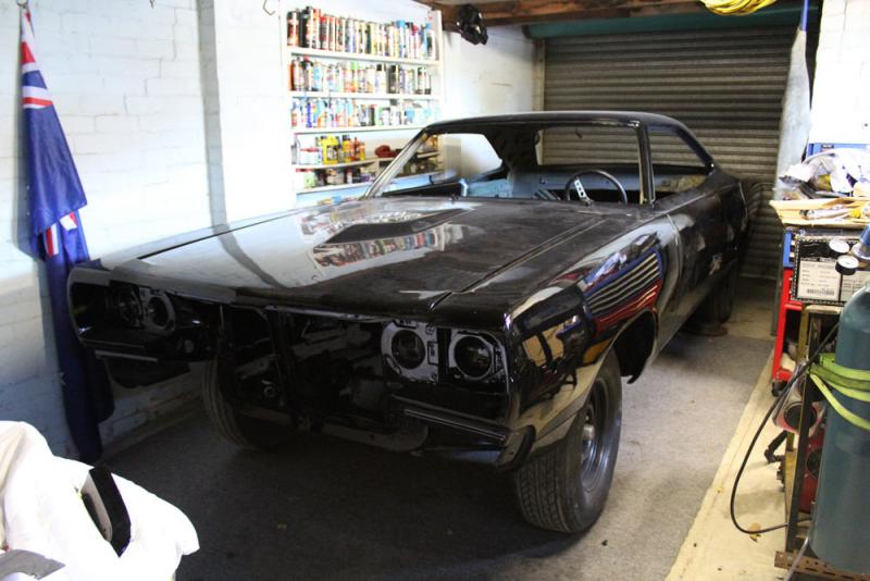

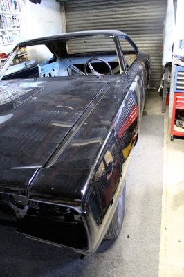

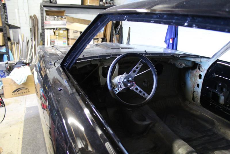

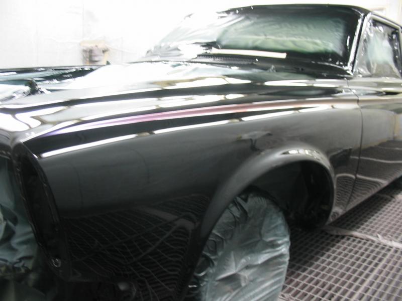

Here's a few pics from the day it came home around Feb this year and a couple in the garage before I painted the interior
I need to get some more pics of where I'm up to now, but usually end up working on the car rather then taking pics of the work!

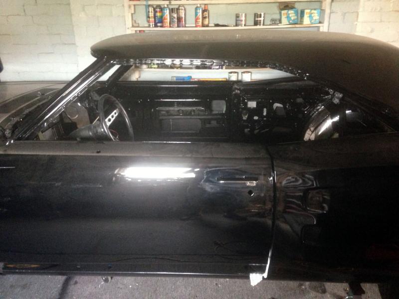

A quick update:

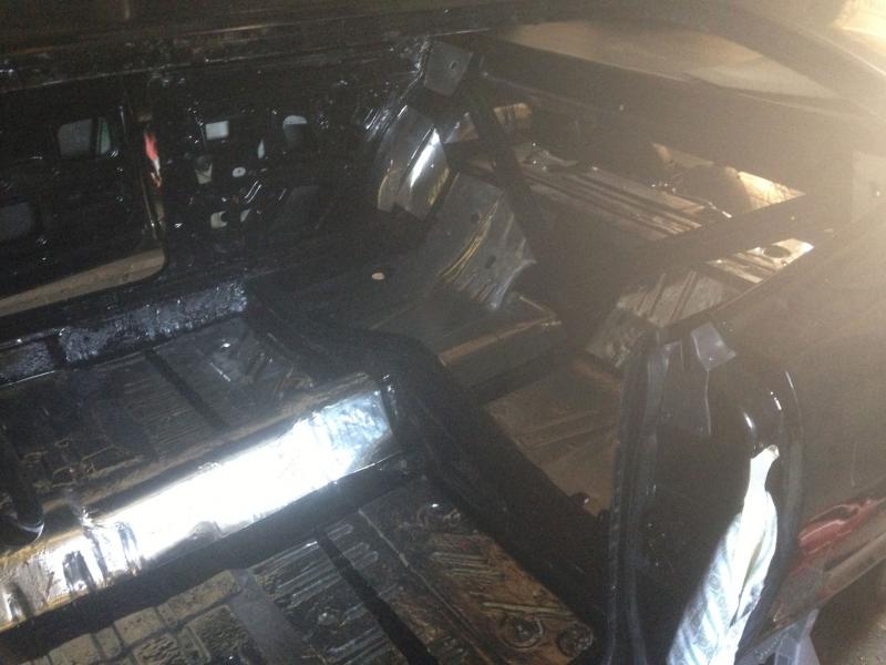

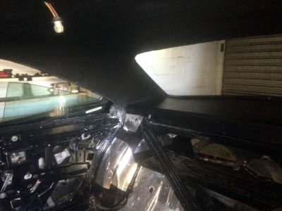

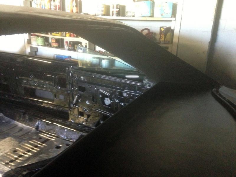

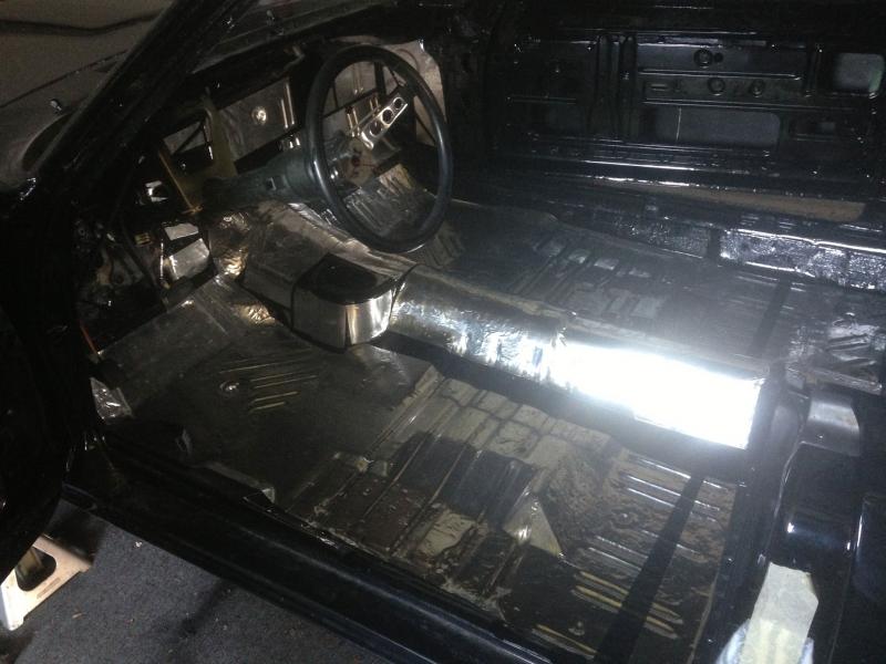

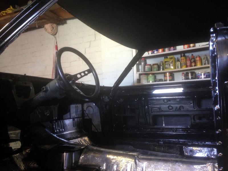

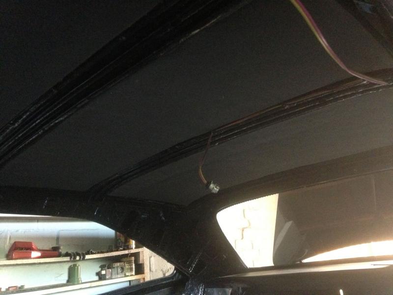

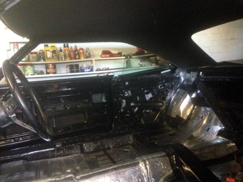

Laid down all the resonate matting, doors, quarters and roof have the sound barrier installed. Installed the door handles. Installed the roof liner. And got one of the rear quarter windows in.
So the hicups: the D!ck that pulled my rear windows sheered the bolts that hold the glass in place, I managed to drill and tao the passangers but I just spent the arvo trying to re-drill and tap the drivers side only to have it snap on me.

The resonate matting, I have some interesting thoughts around this if any one is keen to hear them ;)
Shot of the sound barrier on the roof:
Fkn computer is pissing me off!!
Try again!

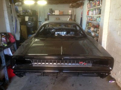

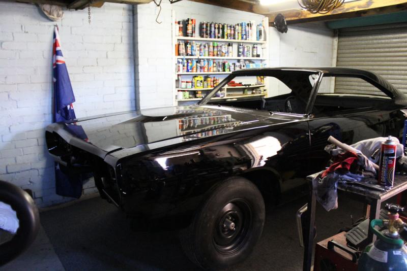

Also stripped re-polished and painted the tail panel. That RT is going to be the only badge on the car. I would have left that off to if I could of!

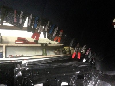

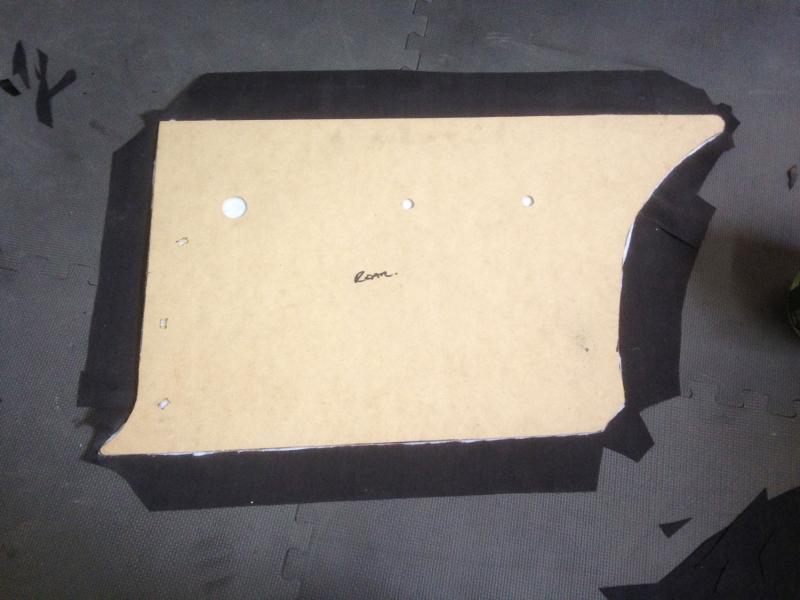

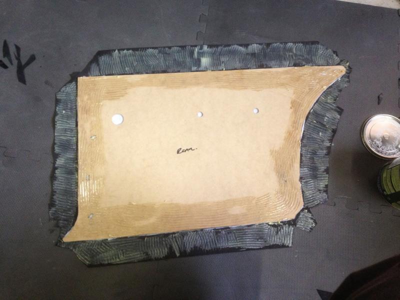

Lastly head liner, pass rear quarter window and you can see the parcel shelf cover I made up. Postage on that and the door cards from the states is insane, so I'm making them for the moment. Maybe when I win the lottery I'll buy some repos!

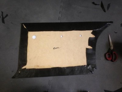

Heres a couple of shots of the making of the rear cards. Its 3mm MDF, with a layer of wadding and a wrap of Pleather/PU. For got to take a front shot, but they've generally turned out well. Need to finish the front door ones soon.

Thinking I need to seal the back fo the cards to prevent moisture getting to them. Was thinking of an epoxing spray paint. but if you have any ideas. I'm happy to hear em!
Please Malicious, tell us your interesting thoughts on the resonate matting. I, for one, am all ears.

Gaawd I love a thread like this...3 months and a dozen posts and this bad *** is painted and being reassembled! Freakin' awesome job and your color choice is perfect...definitely keep the black steelies. Nothing looks bad-***-er than black steel wheels.
Lizard-skin will keep your new fiber-board panels safe, but I think regular old spray paint will do the trick too depending on how porous the material is...it may just soak in. Latex (house) paint is a cheap alternative, can be mixed in any color, and brushed on controllably without all the absorption of spray enamels.

As for the matting; I know with the rebuilding scene its custom to slather as much 'dyna' mat down as possible but I have done some digging and learnt a bit from the audio-philes, I'm hoping for a good result...
The 'Dyna' mat style product is a vibration dampener. Meaning that it cuts out and noise generated by the piece it's stuck to. Example is that stick it to a weaker panel like a roof skin, and when you tap on it, the sound generated will be a duller quieter one. It's NOT a sound barrier or absorber! Key difference. Think about when its displayed, on metal drums with big bass speakers in them. One with out matting vibrates like a mofo and makes an awful racket. The one with matting is only the noise from the speaker, but yo can still hear the speaker clearly!
I'm not saying don't use it, I have! But you only need enough to cut out any noise generated by the car from vibrations. What I've read says that any more then a 50% AREA (important) coverage of dampening matting will give no benefit. Its also expensive as hell, so you can save a few bucks there.
How ever if you want to quieten the cabin down from road, engine, out side noise, you still need something to absorb or block it. Absorbing is not an option because noise is absorbed through area volume, you'd basically have to fill the whole cabin with foam to absorb enough noise. SO you have to block it.
Th product of choice is MLV or Mass Loaded Vinyl. It's pretty new, comes in sheeting and is used to block noise in recording studios etc. Google or ebay it, its pretty easy to find state side. Was a little harder to find in Australia on its own. But I got enough to line the doors and quarter panels, and a piece left over to divide the boot from the cabin. Also found a 'premium' underlay that is basically a layer of open cel foam, a thinner layer of MLV and another layer of open cell foam. I'm using that in the roof and on the door cards. Lastly I found a heat shielding used in trucks that is a reflective heat barrier, foam, thick MLV layer and foam again, that I'll use agains the fire wall and cabin floor. Because I've heard the heat off of a big block exhaust can be pretty intense on the feet. My 'Net will be a family cruiser/bruiser so I need to make it lady & kid friendly!
I've stuck it all down using a Sealies gel contact adhesive, same as I used on the door cards as above. So its down good. Probably ended up costing more, but I think the results are gonna be worth the extra effort/$$.

Thanks for the plastic backing idea! never thought of it, but it makes sense! I'll dial in the fit then coat it. I'll look into the latex house paint too. Paint seams to just soak into this stuff usually, so that might be a winner.

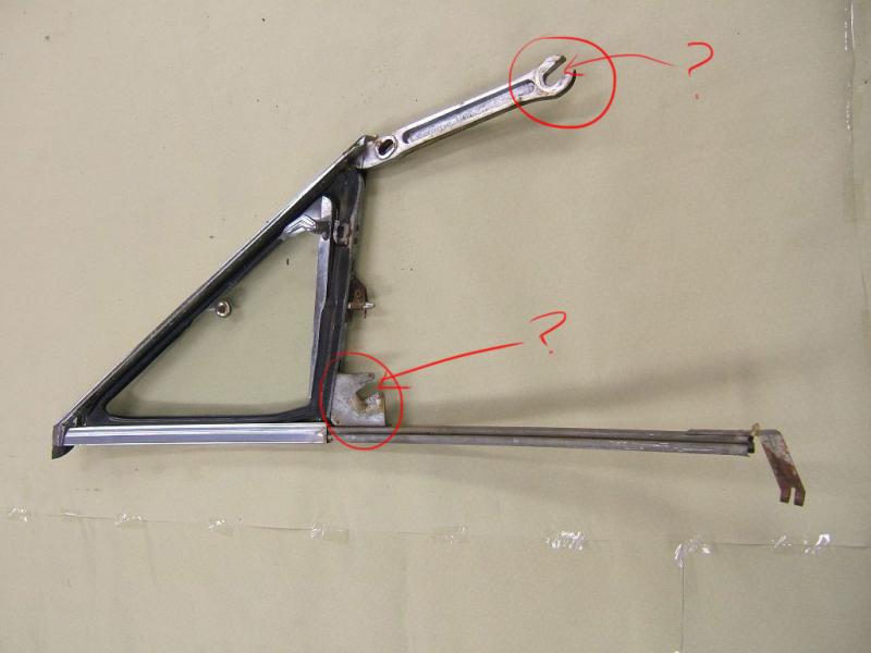

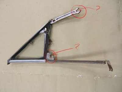

I'm struggling at the moment with the front windows, mainly the Vent window frames. Because of how far away the painter was, I left the windows in to travel (no air dam) and he removed them to paint. So I'm having a fun time working out where everything is and how it goes back together.

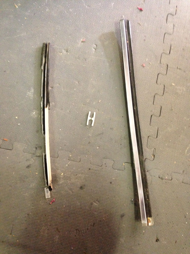

I have the vent windows in place, but I'm at a loss as to how they secure in place. The bolt hole closest to the front edge of the door just below the window is obvious but the other two I have no idea. The manual mentions a bracket, but i don't seam to have anything in the door, not sure if it got removed, Or I never had one. Here's a pic showing the two mounts I'm talking about:
I'm also missing some weather seals from the door glass. I've emailed Classic Industries, but thought I'd ask here as well. The seals I'm looking for are the seal that runs up the vent window channel where the door glass contacts the vent window and the clips that hold it in place. These are the seal and clip on the left of the attached picture.
The other is the furry insert and rubber channel that are part if the stainless steel trim that attaches to the rear of the door window, this is the trim that seals the door glass to the rear quarter glass. It's the piece on the right of the attached picture.
