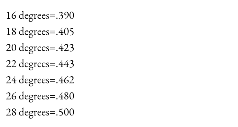

Don't need no stinking plastic key! As long as you have a set of calipers:)
https://www.forbbodiesonly.com/mopa...p-new-residence.114133/page-29#post-910959455
This is my Series 27. Don't know how simular the 25 is.
GTX, funny enough, I did pick up that set and it didn't fit the limiter plate in this distributor. I probably should have said that beforehand. Thanks for looking it up for me, though. I do appreciate that!
Kid, that's getting printed out. Thank you very much.
