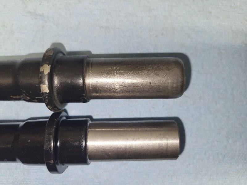

Pressing the bushing onto the shaft is usually pretty easy, but this one went on about 1/2 and then wouldn't go further. I pulled it out of my press and can see that the shaft is scraping on the I.D. of the bushing sleeve and the sleeve material is raised.

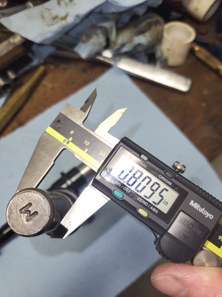

Comparing originals to the Mancini version, i see 2 issues. First, originals have a bevel on the end, Mancini's do not. The Mancini shafts also measured 2 mils larger in dia.
Has anyone seen similar issues with the Mancini parts? Looks like I'll be going back to my originals.
Also, any tricks to remove the new shaft and salvage the bushing? Looks like I'd have to somehow anchor the inner sleeve to press the shaft back out. It tries to pull the rubber out if I just anchor the outer sleeve. Probably easier to just get another bushing.

There is more going on than 2 thou!
Yes but a lot less than 2 mil!
Should have beveled them first. Oh well.
Keep pressing it on until they're good. Or not good.
.002 is quite a bit of difference on a press fit.
That plus the sharp corner will put a stop to assembly.

Unfortunately, I didn't notice the ends weren't beveled until I had the problem otherwise, I would have hit it with the grinder first. I tried to press on, literally, but it broke the piece of pipe I had over the threaded section of the shaft that I was using to press it onto the bushing.
If you are not going to use the Mancini part, cut off the shaft sticking out of the bush. To save the bushing, find a washer or collar that fits over the shaft & press out the shaft from the reverse side. Use some grease when fitting new bushings.
