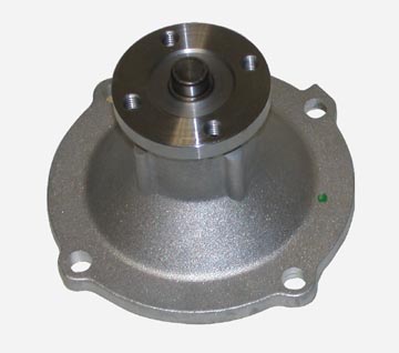

Anybody else using the Mancini Racing water pump? Question about installing it. It was installed on the new motor and it started leaking coolant out the bottom with the engine running, so I removed it to investigate and install a new gasket. It doesn't say "top" on it like others do, nor do the instructions mention any special way to mount it, so not sure if it matters mounting it. If you look at the upper right portion of the pump, you will see the one bolt hole is not rounded like the others, might this signify the "top?"
What would I be looking for when looking for the weep hole?
Is there a weep hole? That should face down.[/QUOTE

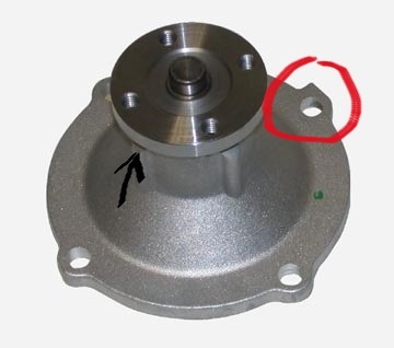

Ok, so I went and looked at the pump, and there's a square groove where the arrow's pointing on the picture (is this the weep hole), so that would tell me the oddball bolt hole should be the top?
image.jpgTypically the "squared" off bolt hole is top (red circle)
a weep hole tends to tell you when the pump is going out because it "weeps" coolant.
Well darn, looking at pictures of the water pump before taking it off and it looks like it was installed correctly. Perhaps the gasket sucked (I hope) or the bolts weren't tight enough.
A weep hole looks like a small (round) hole into the pump, (on the outside) and it usually doesn't flow a lot of coolant, it usually just slowly drips or "weeps" so if you're losing a fair amount of coolant I'd bet bad gasket.
Hopefully it was the gasket. Like Zombie already mentioned, when it weeps, it's telling you the seal in the pump is junk for one reason or another, and it's time to rebuild/replace the pump. That hole is orientated facing down. If it don't have one, I guess Mancini is just counting on the coolant puking out of the front of the shaft when it fails. A bit odd, because instead of being forewarned and having a chance to limp it, now it's hood up on the side of the road.
Good luck. I've seen good reviews on those pumps in the past. I know they cool well, especially with the nice cavitation plate on the backside of the impellers.
