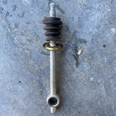

Doing a swap on a 64 Polara, from single reservoir master cylinder power drum/drum brakes, to dual reservoir manual disc/drums. I need the correct or adjustable pushrod.
The stop light switch may need to be modified with an adjustable push rod. There's a tip on stock push rod. Had the problem on my 65 Dodge Coronet.

A stock manual rod 62-65 should work. Ed says that he has one and a I have few too. 66-70 is different.
Yes I'm using one in my 64. Pedal height is good.

I still have the one I posted pictures of.

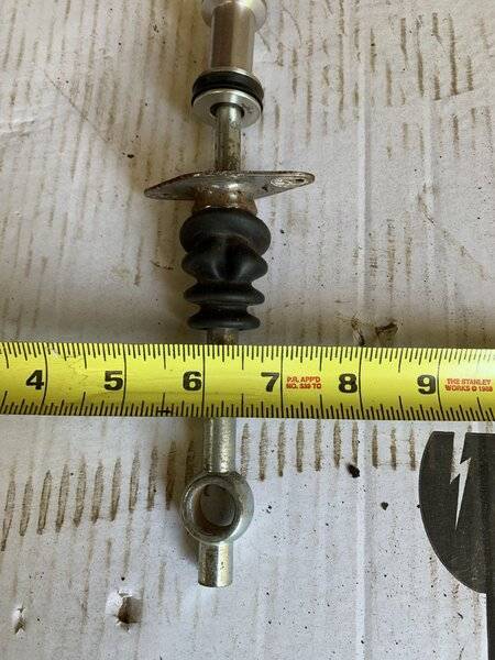

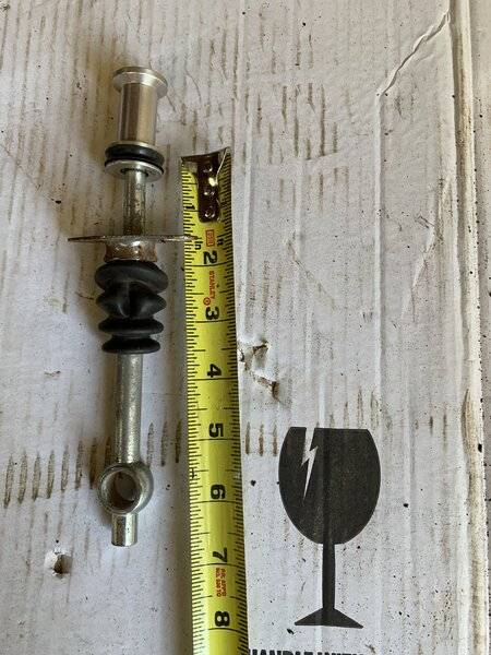

Is this the bare pushrod after removing the plunger from the single reservoir pushrod as in the second picture - or is this different pusrod?
Did you modify the adjustable pushrod or the stoplight switch to make the adjustable rod work?
The adjustable pushrod doesn't have that small nub on the end. That nub hit brake light switch. I move the switch, might be easier to tack weld a piece. I didn't have a welder at the time.
Thanks. I have a new adjustable pushrod without the nub on the end for the switch and I have an original style single master cylinder. I tried removing the pushrod from the single master cylinder - it would not come out - but I guess I didn’t pull hard enough. It would still have that plunger on the end and I don’t know if that comes off.
