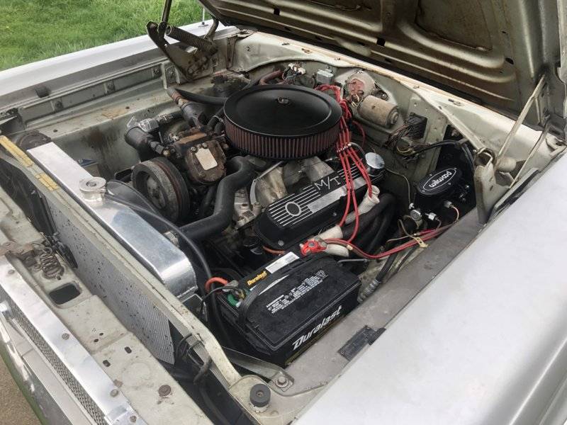

Well, the Wilwood MC solved my issue. It looks great, but requires an inline 10lb residual pressure valve on the drum circuit according to the literature provided with it. I had one on hand already as part of my troubleshooting. It stops great, consistent pedal and with the new rear shoes snd EBC YellowStuff pads up front, I feel confident in its braking capabilities. I highly recommend the Wilwood MC, now I can finally move onto drive train upgrades and my gauges since I can stop effectively haha. If anyone is facing similar issues feel free to PM me, hopefully I can help you avoid the same headaches I’ve had for about a year.
