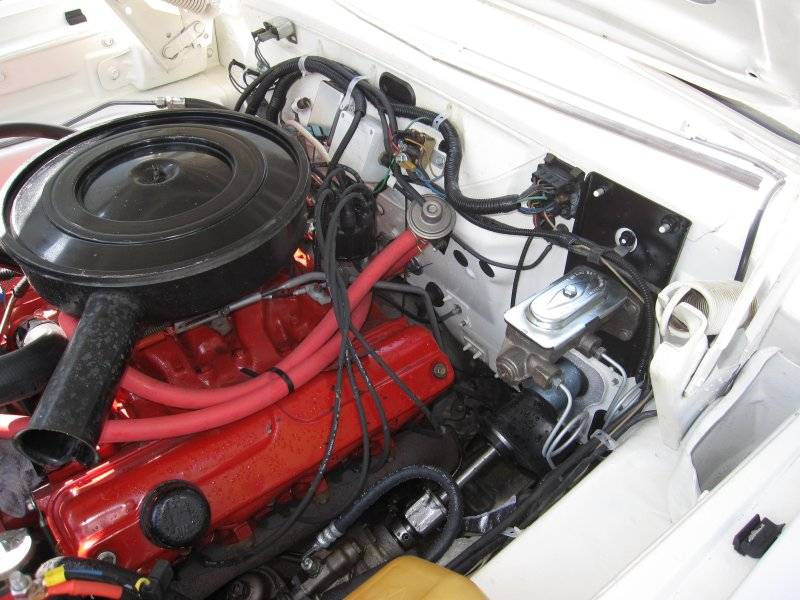

I believe the 67 OEM master will bolt on. Rock Auto is my source for this item. Split the front to rear lines at the junction block below the master and make your own lines.
Mike
You will not regret spending the time and money for a front disc conversion.
Dr Diff is a great resource.
My 66 is converted to dual system.
He just ordered lines and such for a 67.
100% of it was a bolt on. 11" front and rear
My other 66 had manual disc brakes front with 10" rear drums
Being 100% honest.
It didn't stop any better than the drum brake car. IMO
The gain it had is after multiple panic stops or after long down hiil runs where you were on the brakes a lot.
I would just plumb in a 67 up master, as stated above, and forget the booster. A booster on a drum brake system is a waste of time and money, in my opinion.
