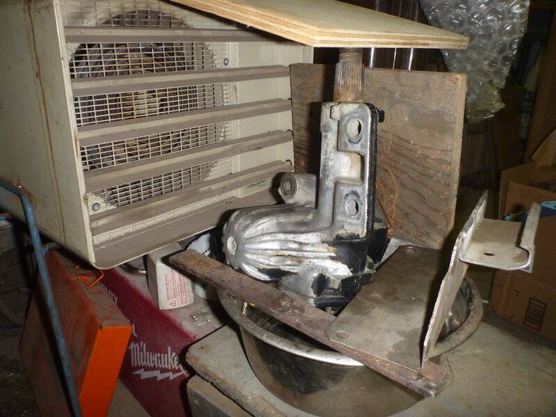

Any play in the box?? If not, pull the drain plug and set the box upside down in a tray in front of a heater. Warm her up, drain the best you can and refill with John Deere Corn Head Grease. Glass blast the case to bare aluminum, spray with Tremclad clear protectant paint and bolt her in the car.

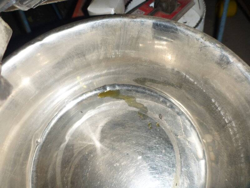

I take back my own advise, as I just tried this with the box out of the Dart, I got 2 small drips out of it in 18 hours. On to plan B with a solvent swish and refill for me. This box has zero play in it so I'm not taking it apart...
