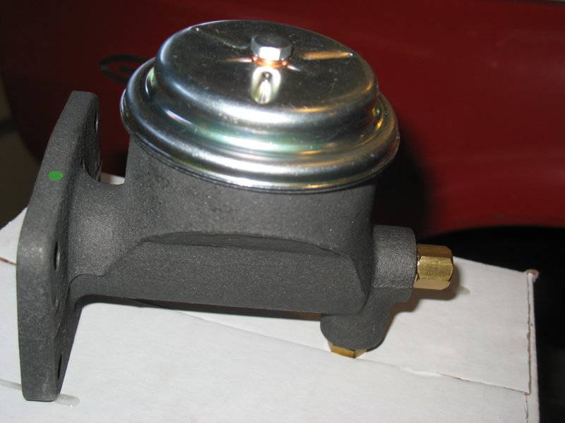

Anyone here willing to step outside the box on help for another brand? I AM , and Always will, bleed Mopar blood! Thats all I own But recently I had to rescue one outside my Mopar comfort zone. I had an elderly friend Gift me His fathers car....an immaculate 59 Biscayne 2 door post. It was too cool to pass up! My last task has been a Hydraulic overhaul of the brake system. Trying to finish the job I have had 2 New Master cylinders, both Leaking past the seals! FYI...I am using Dot 5 fluid which should not be an issue. Both masters came from NAPA....made in Taiwan. Any ideas on Who makes a Quality product that I can feel Confident in when I step on the brake pedal! Maybe this is a message to keep the Bowties out of my house! LOL

Are you buying a "new" or "rebuilt" mc?
I use to find that the rebuilt mc had a better success rate. Things could change though. Maybe shelf life has a bearing on a part that doesn't sell as often.
If you have a hone, get a kit and rebuild it yourself. These are the things that we have to deal with working on these classics.
Good luck!

KID...Both were new with date codes 6/17,& 8/17. So today I ordered a rebuilt in hopes that they are tested before they go out the door. As far as rebuilding the original... piston seized...been soaking for days , no luck yet. Also agree with you on the sitting on the shelf thing, affecting the seals. Also doing alot of reading in web with Tons of compaints with the same issues. not the Lone Ranger!

I failed to mention...This leak shows up on the second pump of the Master cylinder Bench Bleed. The car itself, has flushed out steel lines and All new Hoses, and wheel cylinders.

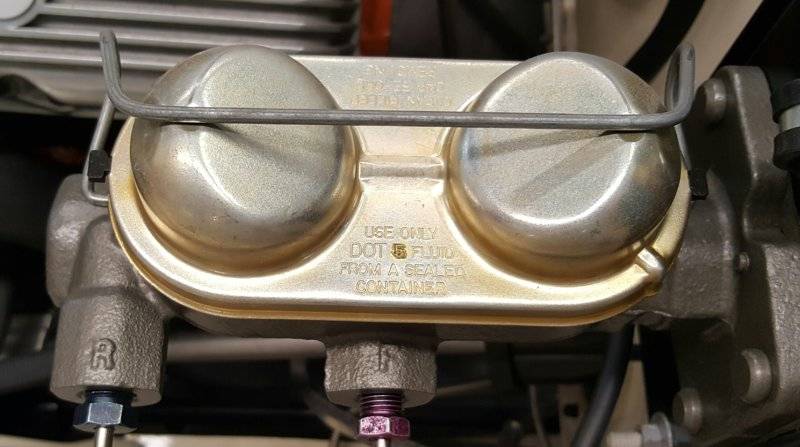

I just had/have the same issue with my 65 Coronet.
Redid everything and stepped on the brake pedal a few times and it leaked between the cylinder and the booster just like the old one did before I redid everything. The same cylinder seals as you?
Picked up a rebuilt one from Autozone and it looks like a really well built unit. The other one was from Advance. Both have the same part # but look different fit and finish wise. I'll change them tomorrow if it gets below 100*

I always use dot3 just so I don't forget and add dot3 to dot5.
One thing is, Dot 5 is purple in color. I've known people putting clear power steering fluid in the mastercylinder by mistake. You'll have to replace the whole system if you do.
Just because I might not be around when the next person goes to top off my MC, I found a #5 stamp and changed the #3 on the cover.
