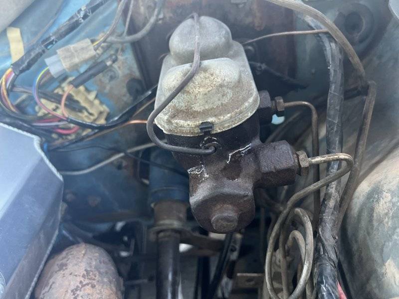

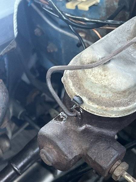

So my master cylinder is leaking on my 71 charger, what would be a good replacement for it? (Drums all around)
So your lid gasket is leaking or it's overfilled... you certainly don't need a new master for that.
the inside is rusty so we want to replace it, but where can i get a gasket if thats the problem?
If the other parts are original then I would strongly recommend new hoses as well at a minimum.
Wheel cylinders as well if you can.
I would flush it out with silicone fluid and get rid of the DOT3. It's nasty stuff.
If you replace MC and if it's a OEM Mopar MC someone might want it. Part number is on it, on bottom I think.
See if you can find a rebuild kit for it. If you can, then disassemble it and dip it in a rust removing solution and then rebuild it if you can.
