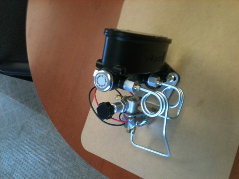

wilwood... made in USA i have the 7/8 bore works sweet and looks even better !!, black powder coated is what i used and love it..
